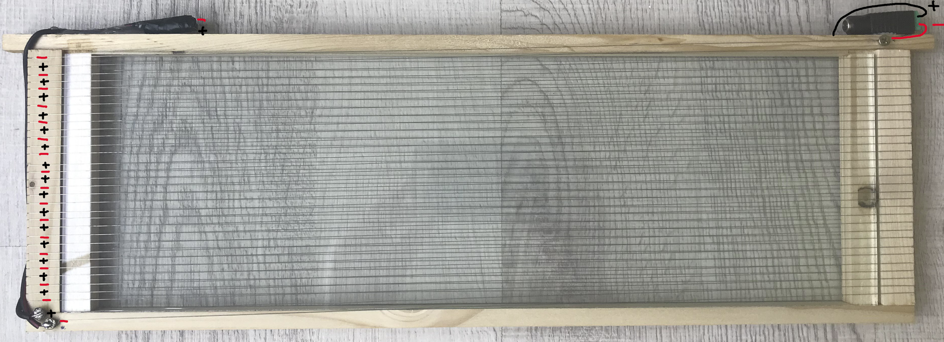

Measured cold? When hot the grid's resistance will increase, lowering the current. In this case that's good.It has 341Ω resistance from one end to the other.
I measured the resistance at around 25 degrees Celcius room temperature, without any load. Therefore wires should be around the same temperature as well.Measured cold?
I'm afraid I can't read your picture well enough. Not a problem of my eyesight nor of the clarity of the image, but what it represents.
It looks like the end of the "+" wire and the end of the "-" wire are not connected. In that case, how would current flow through the wires from the connector's "+" to the connector's "-" pin? In post #8 you stated that the resistance of each grid is between 170 Ω and 340 Ω, depending on wire type. Without the ends of the wires being connected, the resistance would be infinite (well almost).
Yes, they are not connected. I will add terminal systems at bottom.It looks like the end of the "+" wire and the end of the "-" wire are not connected. In that case, how would current flow through the wires from the connector's "+" to the connector's "-" pin?
Then how did you get the resistance values you quoted?Yes, they are not connected.
When the ends of the wires are not connected the resistance is quasi-infinite and you don't need a beefy power transistor to drive voltage only to the grids. A small signal transistor like a BC107 alone can do that.
That measurement is useless, as there is no closed circuit for current to flow because you have left the end of the wire unconnected.I measured start of Frame_1(+) and end of Frame_1(+) and so on for each frame.
I have no idea how this contraption is meant to work. By electrostatic fields or by thermal effects from heating of the wires? Therefore I cannot answer your question with confidence.Are you saying that If I keep the ends not connected, It can still work? I
