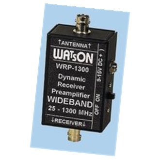

Is there anything I can make that could help boost my radio signal? I came across this thing https://images-na.ssl-images-amazon.com/images/I/31FWZjRCzqL.jpg but costs about $50. The radio cuts out a lot...I have tired other antennas, but nothing makes it better. I'm using a Baofeng UV-5R +Plus. I use the radio for the fire department, other volunteers seem to have the same problem as me. I feel like just the radios that are bad, but just wanted look in to it hoping I could make something that will fix the problem.

The amplifier you looked to send to be for a receiver. If you transmit it will likely go up in a puff of smoke.
