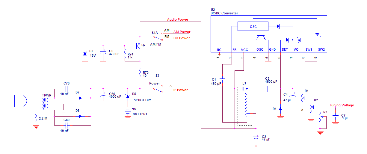

I'm not that skilled with electronics and I would like to power a radio (it's a GE Superadio model) from a car battery. The radio circuit has 12V but the radio works either on 110V or on batteries. I was thinking about soldering wires after the transformer to feed directly with 12V DC while the radio is unplugged. Could this be possible ?

Looking at the page, the used battery seems to be 9 Volts.
Are there 6 C or D type batteries in the battery compartiment?
Bertus
The schematic for the power supply in the post #3 link shows a 9V battery. You would need to check that all components in the radio are rated to handle a minimum of 12V. You also might need to adjust transistor bias voltages at various points in the circuit to cope with raising the supply from ~9V to 12V. Note that 12V is only a nominal value for a car battery: it might well be around 14V when the battery is in use in a car with engine running.

Looking at the schematics you've provided, it turns out that your radio already has extensive power conditioning built in, including a voltage limiter (Q7 etc.) and a switching converter (U2 etc.). Nothing further should be necessary and a direct connection to your car battery (e.g. to the "+" end of C66) should work fine.
