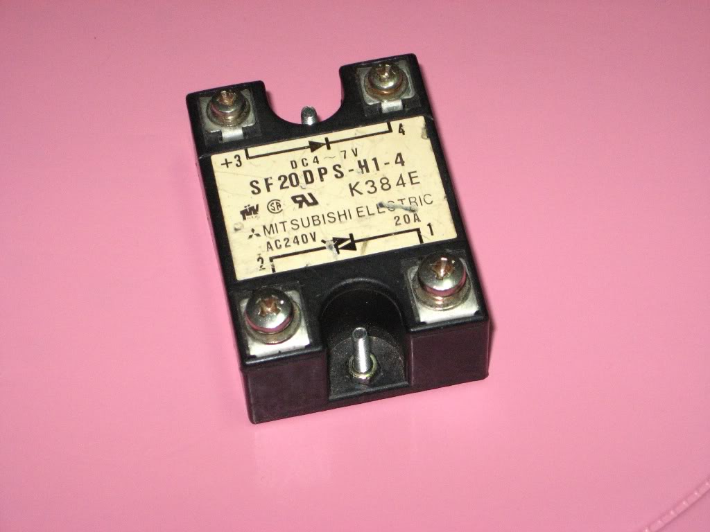

I have got this Solid State Relay , and i wanna make a circuit so that i can use this relay to take an input of 5V and give me an output of 110V (enough to lightup a bulb of almost 60WATT).
What else do i need to make this circuit?

BTW here is the pic of the SSR i have.

You need 5V, 110V, 5 pieces of wire, 1 socket, 1 bulb.
Wire the bulb in series with terminal 1 or 2, and then connect the other terminal and the other end of the bulb to 110V.
Apply 110V.
When you then apply 5V to terminals 3 & 4 the bulb will light.

You said i need to wire the bulb with Terminal 1 or 2 in Serial, can you please elaborate this? Did you mean to connect the the terminal 1 or 2 of SSR to the -ve(GND) of the Bulb?

The circuit you posted here is just the way it's supposed to be.
The SF20DPS-H1-4 has a built-in resistor in series with it's IR-diode and is specified to work with an input between 4 and 7 Volts.
I don't know though how much current it draws, and how much current the Arduino ouput is capable of delivering.
If the output from the Arduino is too weak then the voltage will be too low and it might not work properly. In that case you only have to add a transistor on the breadboard.
There are several configurations possible in that instance, but if you use the emitter-follower configuration you don't even need an extra resistor.

Arduino pin delivers 40mA of current, i think it should be ok to use with SSR, or should i somehow calculate the amount of current required for SSR to operate?
Ok, you're good to go then, 40mA should be plenty, the SSR surely draws less than 20mA, more likely around 10.
But you'd have to measure the actual current if you'd want to know for sure. I found no data on the net about the resistance or current.
It'll work just as well, using loads from 2 to 110W, and has an input current of 10 to 17mA.

The other SSR you had was rated at 20A and should stand a bulb-short without the protection of an extra fuse.
The big one you posted a picture of in your first post can handle 20A (2kW) and would be able to withstand a short where only the house fuse protects the circuit, so you wouldn't need any extra fuse.
