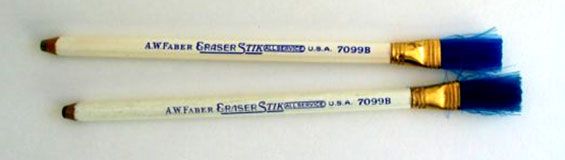

Any chance that you are familiar with typewriter erasers made either as a round cartwheel with its adjunct plastic "flick away" brush or they made them also as about 3.125 mm white abrasive cores with a wooden pencil type surround. Eithe of those have worked great for me in taking off / erasing off that layer of DEAD rubber.
You NEVER want to use a cleaner solvent on the rubber INITIALLY. You have the rubber element in BRIGHT light and you can see a shiny glaze of dead rubber. You then use micro strokes to remove dead rubber and it tells you bu transforming into a flat matte finish instead of the shiny finish. You work your way S L O W L Y all around the units total circumference until you have covered all. THEN it is permissible to use the cleaning solution on a white cloth and try to linearly rub and collect the last vestages of dead rubber. When the while cloth stops coming off black, you then have all traces off and hopefully a lively gripping drive again.
So now you tell me no typewriter eraser. I have also used a wooden popsicle stick with some #400 or finer silicon carbide wet 'n dry paper cemented to it. May need several as they clog up.
This works for 70's up equipment since their rubber is really a synthetic compound / mixing of butadienes
neoprenes bunas and vinyl blends with a bit of carbon black thrown in.
If you had some drives prior to 1950's or so you then might have some hard as rock rubber and no hope of reviving it.
Typewriter erasers looka-lik-a
Thasssssit
