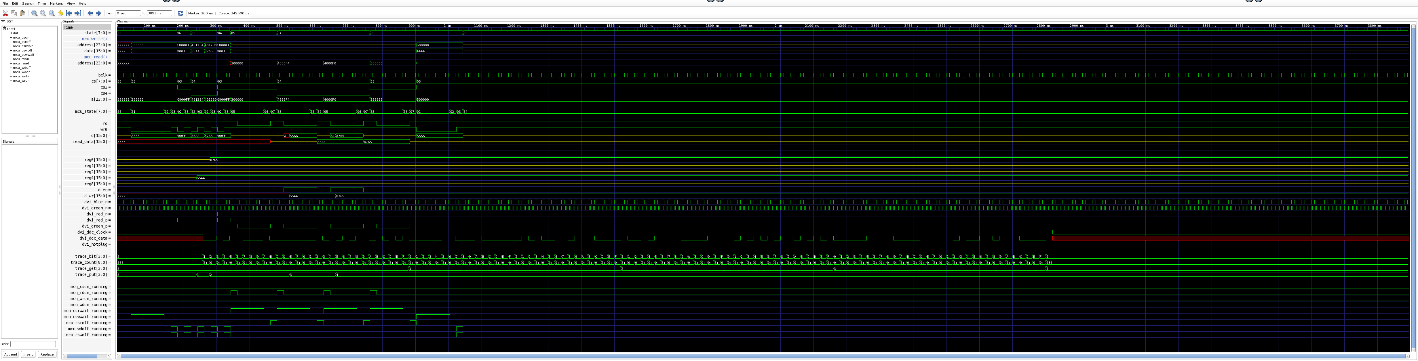

DJ said:
It's over four feet from edge to edge, so yeah, it's kinda big. And
that doesn't include the fourth monitor on the shelf above them, or the
laptop's monitor (five LCDs total). I'm building a bigger desk :)
To give you an idea of how wide the main desktop is, here's a snapshot
of a window that spanned all three main monitors (across, not up/down):
http://www.delorie.com/tmp/play2sim.png
My son has decided that two monitors works best if one (side) is
portrait and the other (center) is landscape.
Wow! How did you manage to butt the glass together so no seams show?
