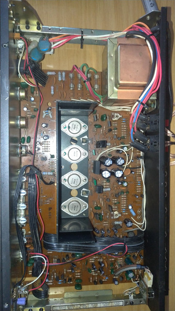

Here is an image of the interior of the amp
I have some oxydation traces on the bridge rectifier but with 31V AC input it outputs 24V DC which seems normal to me...

Of course I replaced capacitors with ones that have the exact same capacity and voltage rating.
As for the polarity, I made sure to put them in correctly (it is labelled on the board).
I did the measurements again without any load, AC input is 48V with DC output 64V, and ripple is 12V.
With speakers plugged in, input signal and volume at max, the measurements are exactly the same and ripple is around 10V
I don't know how the measurements can be so different from the previous time but it is probably my fault.
Sorry about that...

The output from the bridge rectifier is 64V DC but goes into four caps and their output is 32V.
I don't know if this seems really bad, shoud it be lower?
The 25V caps are not located on the same circuit and they don't seem to be part of the power circuit.
That's a useful pic. So the schematic shows ±30.5V, i.e 61V between the two power rails. If that's under the full working load and your measured 64V is under a lesser load then it's about right (32V per cap).
However, there are no balancing resistors shown across the caps to help equalise the cap voltages, so if one cap is leaky or different in capacity from the others the voltage across it might well be much greater than its rated 35V. There is so little margin between 32V and 35V that I'm surprised such a reputable amp manufacturer as NAD didn't use higher voltage rated caps. I certainly would have..... but I'm not a manufacturer trying to cut costs.
