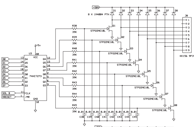

I'm trying to make a simple solenoid driving board for a pinball project, but running into problems. The basic requirement is to be able to repeatedly pulse 50V coils for about 100ms or less each time. I looked up the schematics for how some commercial boards do it, and found two nice examples:

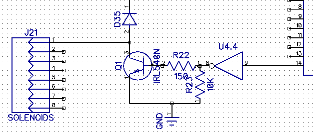

Based on these two designs I prototyped a similar single circuit with an IRL540N (equivilant to the STP22NE10l), a 10k pulldown, and a 160 ohm discharge resistor, controlled by the GPIO on a PIC32, but I found that within a few pulses (each a second apart) the fet becomes too hot to touch and soon begins to smoke.

Show us your own circuit, looking at similar circuits doesn't help that much.

Your schematic shows a bipolar transistor, not a MOS transistor. Assumig an NMOS in the correct orientation the circuit looks o.k. on paper.
I based my design off the first example which used pulldowns as it made more sense
The 74ATC04 has a push-pull output, pull-downs are not really required in operation. They are useful, however, when the low voltage circuit is not powered to definitely turn-off the MOSFETs.
