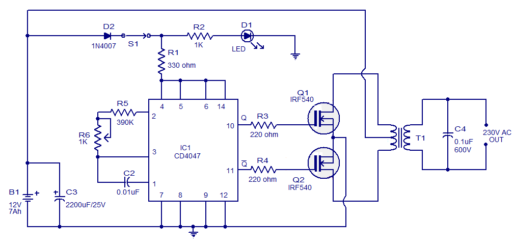

I have built a simple inverter (12vdc to 120 ac) using a cd4047 to drive (2) n channel mosfets. The output seems very weak, and I noticed I only have about 2.5v of gate voltage. Could anyone recommend an amplifier to put between the IC and the gates? Would adding mosfets in parallel help? I'm dealing with pulsating DC, if that matters. As you can tell, I'm just a beginner. Thanks for any advice you can give me.
