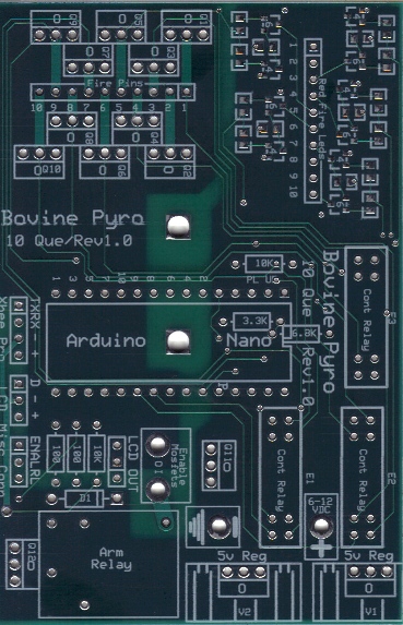

I see no functional issue with your via placements.
As for the plane connect, the relief connect is generally a good idea for all hand soldered boards. Otherwise it becomes very difficult to work with because you have a lot more thermal mass. The exception would be RF boards where solid grounding can be the difference maker in meeting spec.
ok perfect I didn't know if it was bad to just touch the SMT pad to the Via instead of running a trace wire.
And i will keep all as thermal pads even if there's no solder going there..

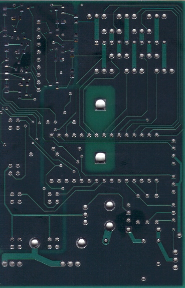

Boards are HERE!
Here is a scan of them on the flat bed scanner
