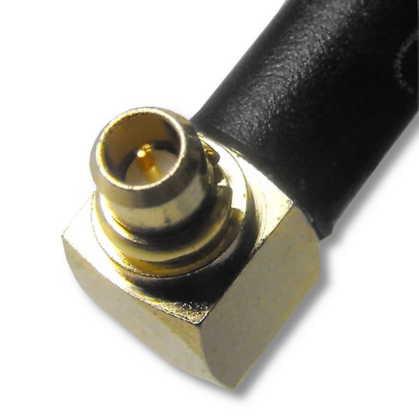

The usb tuner comes with a tiny micro (3.5mm dia approx) aerial cable socket - but my roof aerial with standard car hifi type cable and connector.

Nope - neither of those look like my connectors - I'll try and attach compressed images of both and see if they upload...
The larger fitting is the aerial, the TINY one is the one which comes with the usb tuner.

the large image is a standard Bellinglee TV antenna connector
the small one, unfortunately you didn't supply an end on view so I have no idea ..... as it, it looks like as DC power connector
as in, I don't recognise it as a RF connector .... it may be some oddball version of a MMCX RF connector

Massively grateful for your help - the adapter you show on ebay looks like the one I need! I was resigned to it not existing as an ebay search was the first thing I tried.
Close, but not quite the one. Mine doesn't have so many split segments or the internal white insulator. Thanks for your help though. ( :
Number of splits is just manufacturer's preference. If you use the short solid adapter, be careful to support the attached cable so it doesn't damage that little MCX connector.
