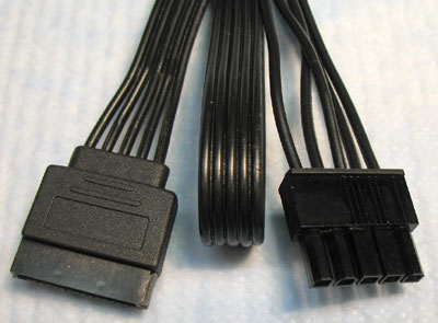

as for manufacturers, I haven't found anything that i would consider exactly what i want. there are several PSU manufacturers that use 4-6 conductor ribbon cable for their modular lines like this:
But finding the wire alone is proving very difficult.

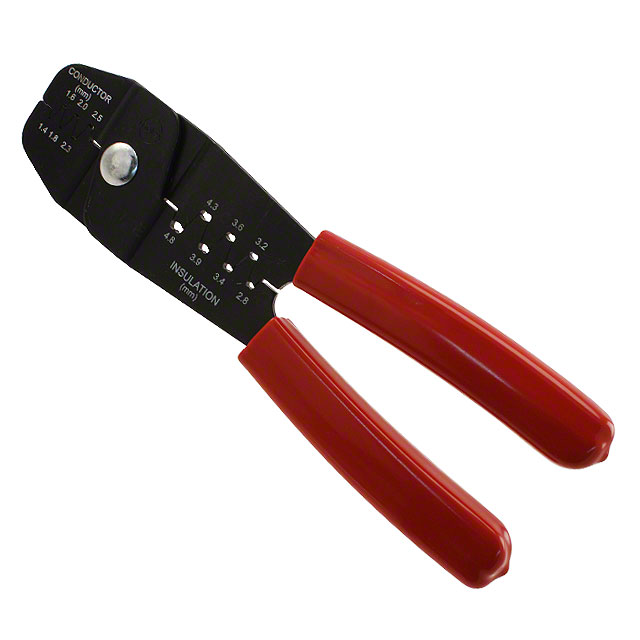

One other question, any suggestions for a cheap crimper than will handel Molex Mini fit Jr. crimp terminals?
I like many others have likely felt your pain after looking at the domestic offerings and OEM offerings on crimpers...
I went on a quest to find an cheaper alternative and came across the Engineer Inc. 'generic' crimpers out of Japan, IMO they are a VERY decent tool and they crimp damn good for a generic fit all type crimper.... I can do the factory looking/quality, double turn down crimps without any hassle now...
I link to this site only because it has a reference table...
http://store.iheartengineering.com/info/Crimper_Compatibility_Chart
From that it appears the PA-20 crimper might be up your alley, don't take my word for it verify the sizes and sorts with your own research, I only glanced at the datasheet for the connectors...
FYI there are some youtube videos of these crimpers in action
