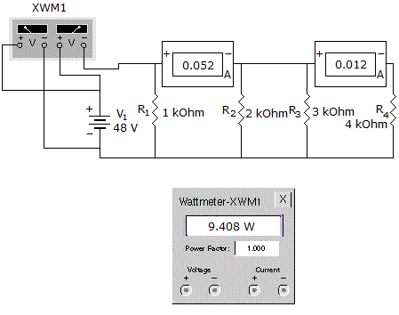

Which component is of the wrong value?
Which component is of the wrong value? n why? Answer is given as R1.

I have calculated equivalent resistance which comes out to be 480. Thus current comes out 0.1A. Then power comes 4.8W. But wattmeter shows 9.408 reading?
Perfect. Do take a look at the Ammeters in the drawings to see which part of the circuit is behaving properly.
Should I find out the loop currents by applying KVL,KCL
Yes. Ignore the readings on the ammeters and wattmeter until you have completed some of your calculations.
If the printed values match your calculations then you can state the components function correctly. Otherwise you know where the faulty component is.
