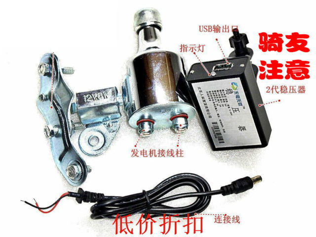

Of course it will, just not very efficiently but conveniently. The "add on" market for bicycle road lights that are energized by a generator, driven by one of the bicycle wheels through a friction contact with the tire casing near the outer rim, is a good example. With LEDs replacing incandescent lamps for road lights, the need for a bicycle-mounted generator appears to have decreased in favor of using throw-away alkaline batteries, so it might be a bit difficult to find a bicycle-mounted generator today that isn't made in Asia.

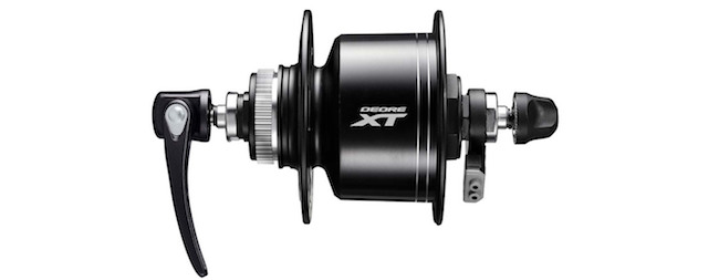

As a matter of fact, when I started investigating bike powered generators, I discovered that those are not only still around, but the technology has actually improved. Modern bike 'dynamo' generators are actually magneto generators, and have been incorporated straight into the hub. This helps eliminate loss of energy from friction and general tire wear:
They are apparently still used by touring cyclists, and bikepackers, who like to travel very long distances without necessarily having easy access to grid power. However since they're designed to be used while the bike is actually travelling somewhere, they try not to sap too much of the riders energy. They produce somewhere around 1.5 to 3 watts, which is a far cry from what I've seen from stationary generators.
