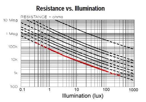

What a log amp could do is make it easier to set a threshold level for switching between full daylight and full darkness, somewhere between dusk and dawn for your application over a wide range of light levels. Your current design works fine, but the voltage divider resistors that set the switching threshold were determined by trial-and-error. Not much illumination lee-way is provided with a linear potentiometer in series with the voltage divider, nor does that much accommodate variations among LDR sensitivities if you need to build more than one.
A log-amp would compress the huge range of LDR resistance variations that occur as a function of light intensity into a linear span from which you can easily pick a threshold level from full daylight to pitch black darkness. Of course the span isn't really linear, it's logarithmic, but the effect is to "linearize" the LDR response.
I think it might be worth your effort, from an educational point of view, not for your Halloween decoration, to at least breadboard a simple logarithmic amplifier circuit and "play" with it. You could start with circuits that use just one BJT and one op-amp to do this, but of course simple circuits are extremely sensitive to variations in temperature.
