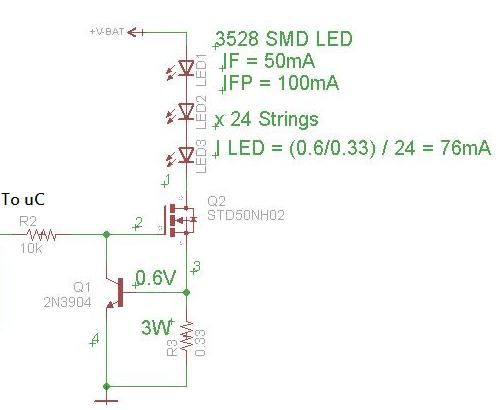

I've build this circuit to drive my powerleds. Works very well.
The question is about the Vbe voltage on the feedback transistor.
The schematic states that it is 0.6V
The datasheet states that it is 0.65V min and 0.85V max
How can I best calculate the resistor value for getting a fixed current?
Should I assume 0.6V or do I need to measure it in the active circuit.
And what determines the 0.2V min/max difference?
The leds I use use 125ma at the brightest that I need them (light vs heat) and a pwm is going to be attached to dim them from that setting.
There are 5 leds in parallel (3W COB leds).
So the total current will be 625mA. With a 12V PSU connected the voltage over the mosfet is low and keeps it cool @max current.
