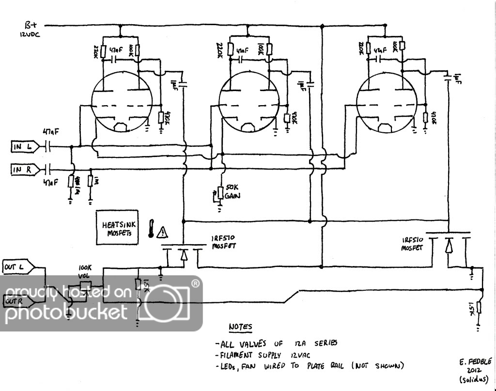

There's no reason to abandon the original design. It just needs to be modified for use with a low impedance load. Speaking of which.... We discussed the that the 12AU7 amp was intended to drive a high Z input guitar amp. This discussion was quite extensive early in the thread. You never interjected to tell us you intended otherwise.

Just let me know what I need to change or show me a revision on that circuit to allow itself for low-impedance use and to make it work right, and I will go on my merry way, let this thread die and try and figure out my own problems if they arise.
