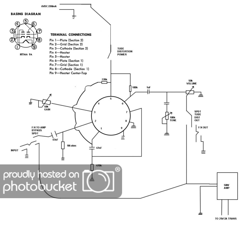

Valve (tube) amplifier schematic help
update - I just destroyed a 6VDC/200mA power supply's enclosure with a hammer.
Will that work at centre tap on the filament?
Will check data sheet and post revised schematic in a little bit for review.
For convenience I inserted a screencap of the valve pinout into the schematic.
Does this work?
Heater @ 12V: Heater wired in series. Heater current = 150mA
Heater @ 6V: Heater wired in parallel. Heater current = 300mA
What do you think?

If you are using a transformer, you can use AC or unfiltered DC for your heater.
That will be more friendly to your transformer and ease the requirements for filtering the DC.

To power the heater directly from the transformer none of the heater pins can be referenced to ground. You must lift pin 4 off ground. I just wanted to make sure you understood this.
Also, a 12V transformer when rectified and filtered will produce B+ of about 16V.

Here's the power supply schematic

Here's an update to the PSU with an RC PI filter. It should provide ripple free B+ and decoupling between the stages. Back in the my day 100uF caps were physically very large because we were working with much higher voltages. You could probably get by with much smaller filter caps, like 25uF to 35uF but since a 100uF/25V or even 100uF/35V electro's aren't large these days I chose them for super ripple free filtering.

Now what would the B+ line be coupled to?
Also, could I still go the route of using a 12VDC wall supply? I'm not so sure I'd feel confident building that, but we'll see when I go to buy the next round of components.
Would the B+ line be coupled to the 1,6 plate lines?
Does that circuit for the supply require a detour of the original circuit to an extent?
Yeah, sure. Get a switchmode supply rated at 1A or more and you'll be able to drive the heaters and the rest from the same output.
You may get a little hash from the power supply on the B+ rail, and considering the very low current, I'd just use an RC filter to reduce it (you could go LC if you wanted to at little additional expense due to the very low current). I understand you may want distortion, but you almost certainly don't want noise :)
As indicated on the schematic B+ is the Plate Supply. It gets connected to the 9V supply line on the amplifier schematic.
Earlier I suggested a wallwart but you wanted to build your own power supply. Well, this is it and it's quite basic. If it's too complicated how do you intend to build the amplifier?
On second thought disregard that. Working with Mains power is not a recommended novice endeavor. Use a wallwart.
