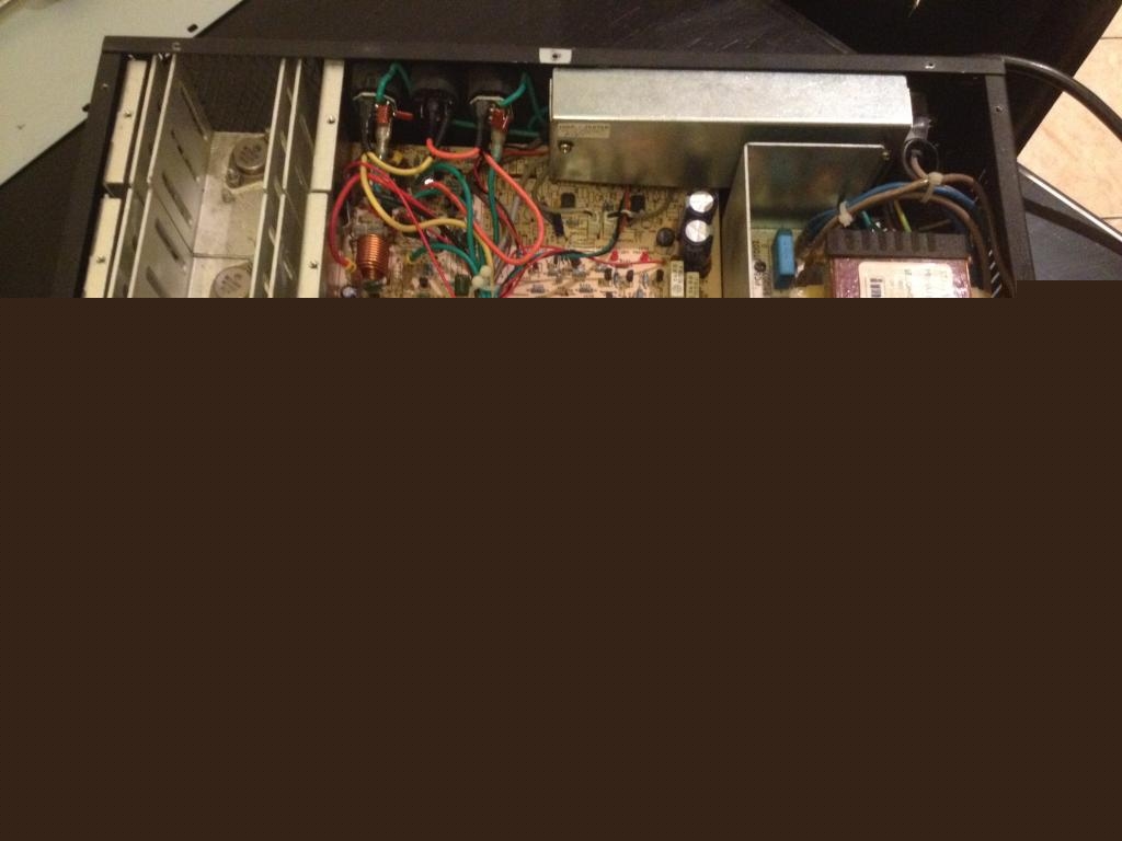

looking inside the amp with it switched on, the fault left led is lit,
but the burned resistor seems to be on the right side,
the plugs where you connect the speaker cables are left and right chanel as your looking at the photo,

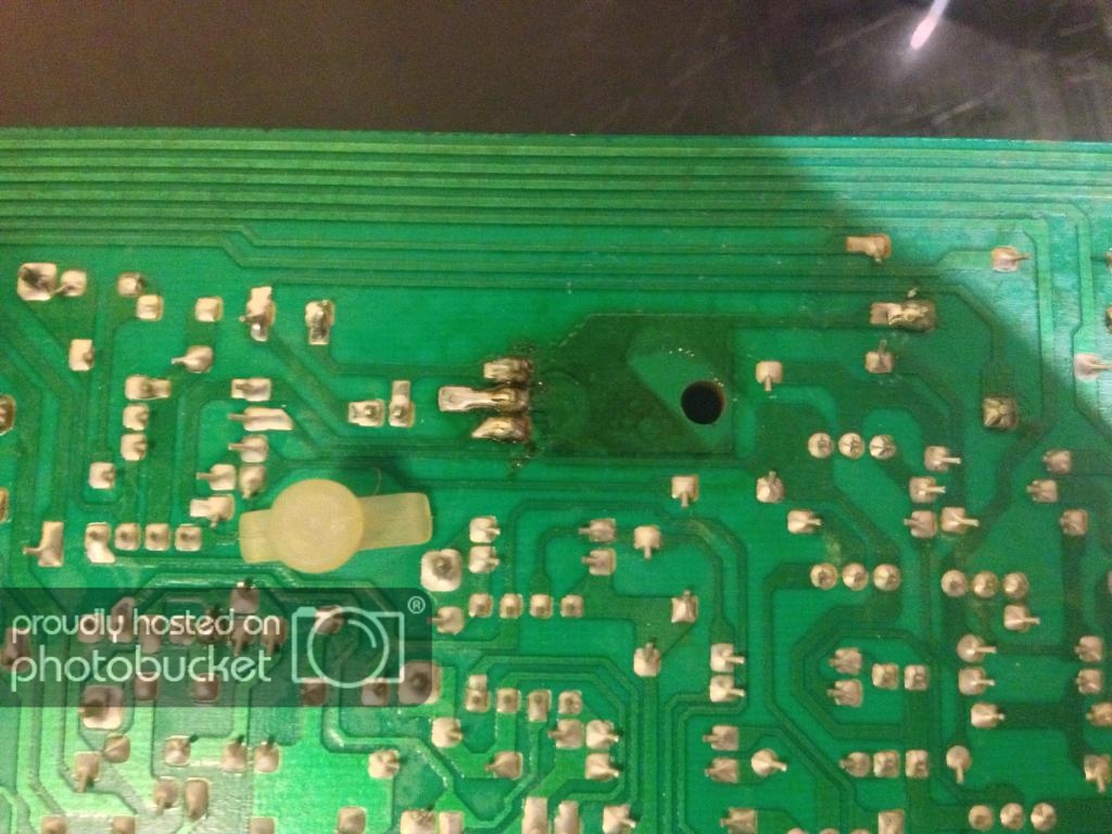

so you meant resistor and not a diode I assume ?
I don't see a burnt resistor as such in your pics
I do see the resistor leg has got hot, you will probably find if you look at the solder side
that that resistor ( maybe other components) have gone dry jointed and have been arcing
causing the burning
go over the board with soldering iron and solder sucker, remove the dry jointed solder from any crappy looking joints using a solder sucker or solder wick and then resolder with fresh solder

Wow, that's a pretty impressive looking amp!
And thanks for the details and history in the first post. This could be important.
Where is this blown component? Is it somewhere in the second picture in post #4? I don't see anything obvious.
Dry joints are a common cause of problems. Also, possibly, deterioration of the insulation on the output transistor heatsinks.
I think I would dismantle the heatsinks, measure the output transistors and driver transistors (marked in red and green respectively on the image below), check the driver semiconductors on the main board, resolder all suspicious joints, then go through a careful step-by-step reassembly and reconnection process.

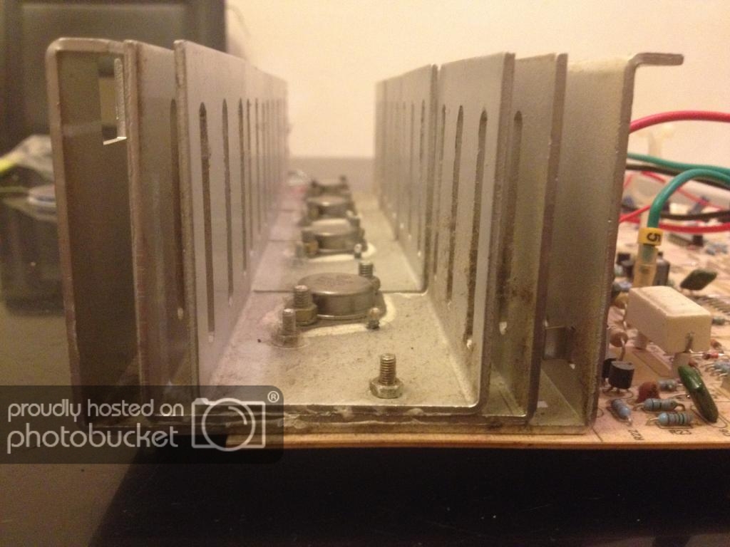

I think that amp is using a strange two-layer construction for the output transistor heatsinks. There should be eight output transistors, not just four, and I think the other four are underneath the horizontal parts of the heatsinks for the other four. This will require some care and note-taking to disassemble and reassemble properly.

yes the only thing i can visibly see is the resistor leg in pick 2 post#4 that has discoloured,
i have has the board out and could not see anything obvious, ie burned out tracks,

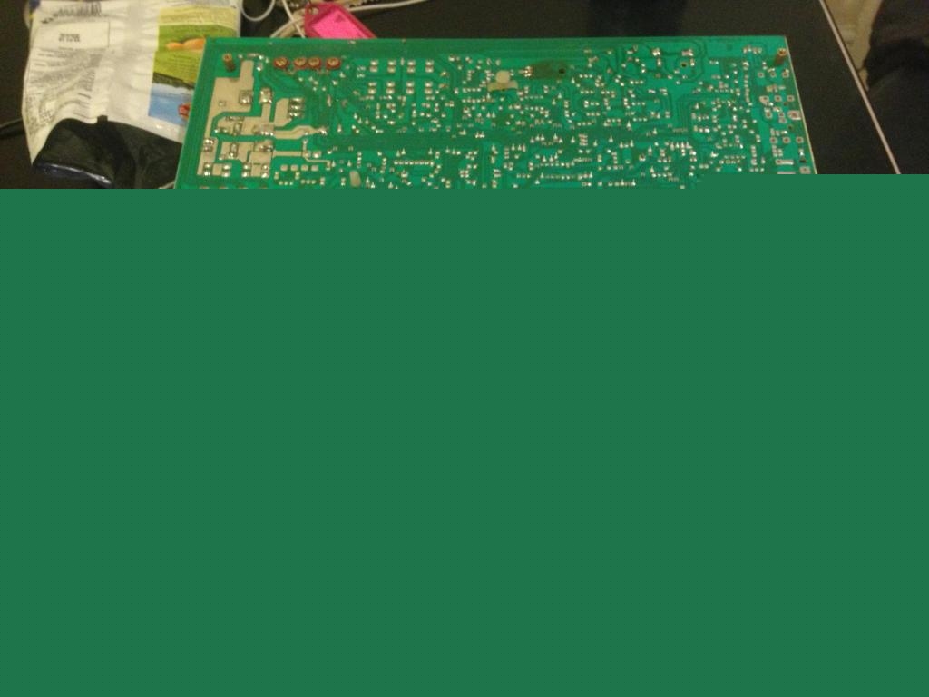

Is it possible to remove the circuit board and output transistors from the case? I would like to see some good clear photos of both sides of the circuit board, as well as photos of the heatsink construction.
Just looked back on some of the pictures I took before I removed the board, and yes my fault I have put the live and negative the wrong way round (doh!!!) will put them right later tonight and see what happens, going to have to stock up on fuses I think, will upload some more photos for everyone hopefully later tonight :)
after rectifying my earlier mistake and replacing 5 fuses ( 4 on the board and the main one in the back of the case) i now have both left and right fault led's lit, and it blows all 4 fuses on the board, only tryed this once!
i now have fault left and righ led lit !!
under side of moroco tip30c
under side of main outputs
