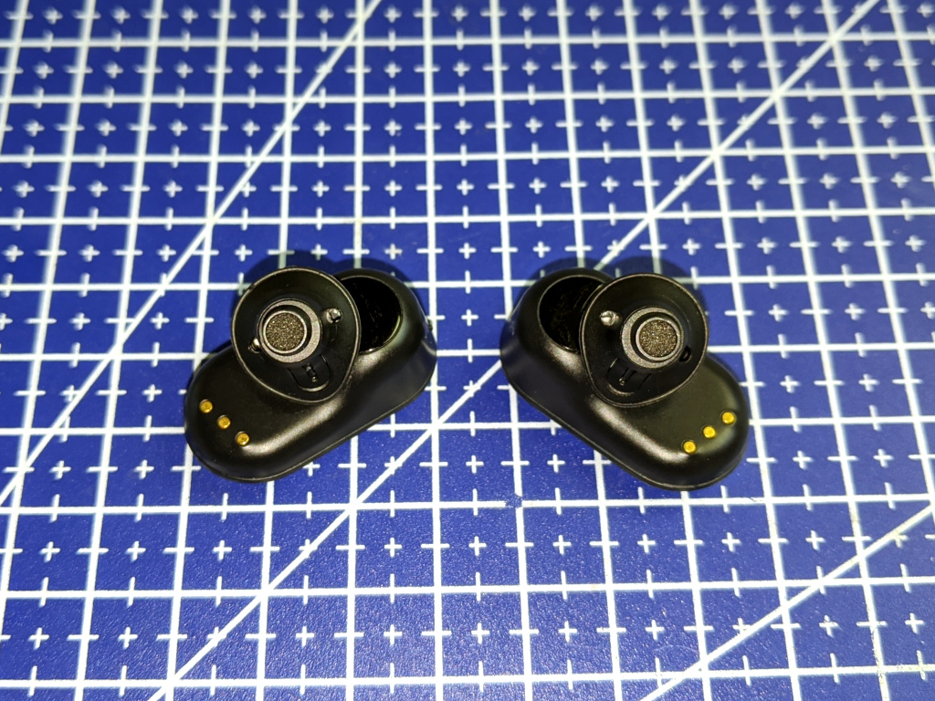

Ok, I fixed it, I noticed that there is a lack of grill foam inside of the headphones just like those below:
and knowing, that just by touching the entrance of the headphones even slightly, screeching noise dissapears.
I cut temporary replacements from dish washing sponge, and everything works perfectly, what a weird issue that was :D
Hope someone will find it helpful.
Best Regards!
Maybe some kind of feedback from the ANC? Good to know you solved the issue.
I don't think the foam can disappear, so it must have been missing from the beginning. These sure are originals, no cheap copies?
