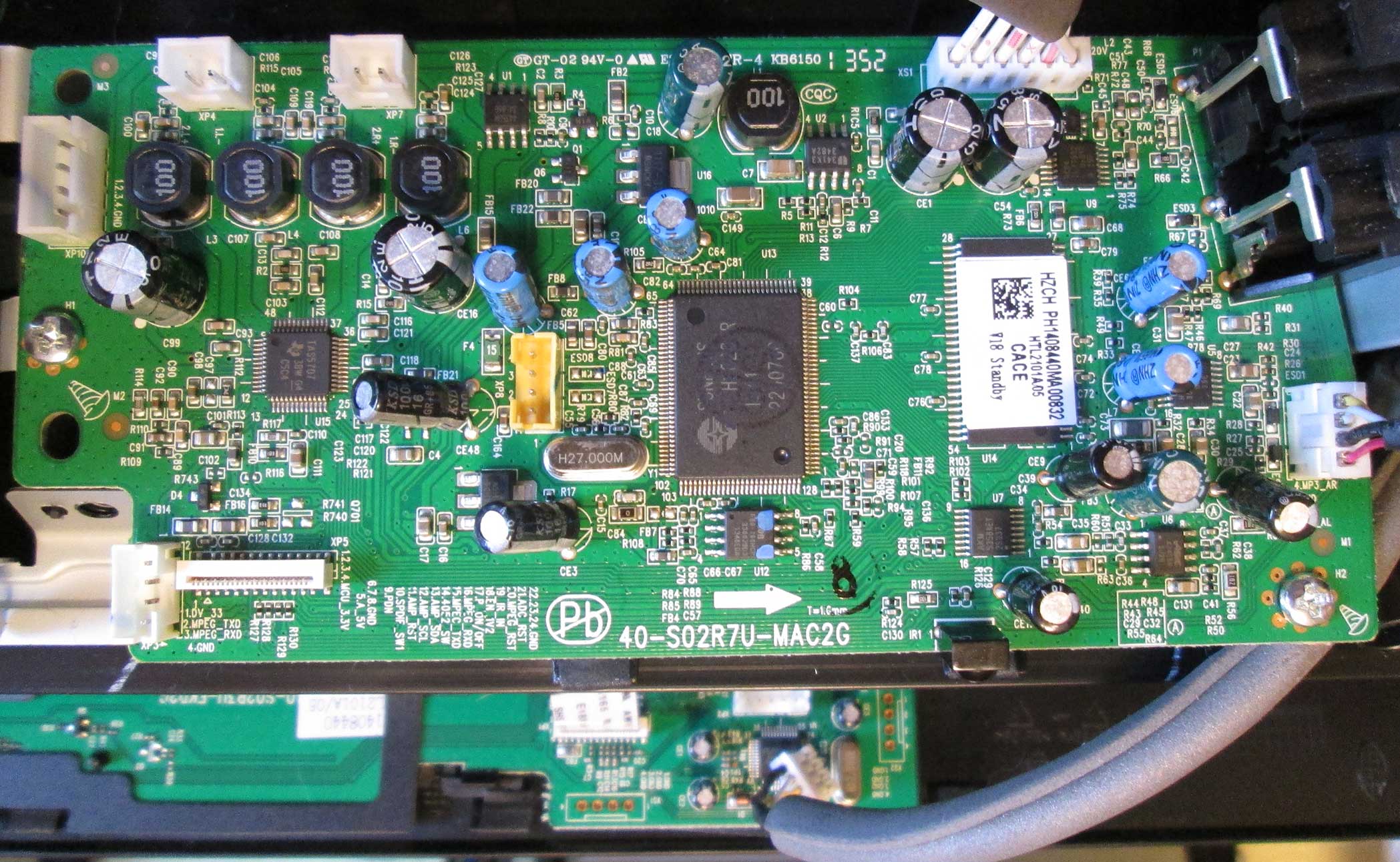

well, I decided to pull it apart to have a look... there's nothing obvious to me (no surprise)... how about you?...
The cable at the top of the image with 6 wires, goes to the power board that supplies 3*18v + 3*GND
The board in the background at the bottom of the image is connected by ribbon cable to the socket in the bottom left of the main board... but this lower board only has LEDs on it - the soundbar has no buttons on the unit, and is fully controlled by the IR remote.
The cable plugged in at the far right, along with the disconnected cable hanging below, go to 3.5mm and USB sockets.
Hi Andaho.
What markings / numbers are on the chip UNDER the white label? Probably a micro-controller pre programmed.
Also, it appears that a lot of standby ic's are actually voltage regulators with built in standby.
Can you get any photos of the power board.
Martin

Good thinking Martin. Think what a boon it would be to have software that could convert PCB photos (with labeled components) to a schematic!
Yes, I'm fully expecting a post informing me that I missed the memo regarding that!
