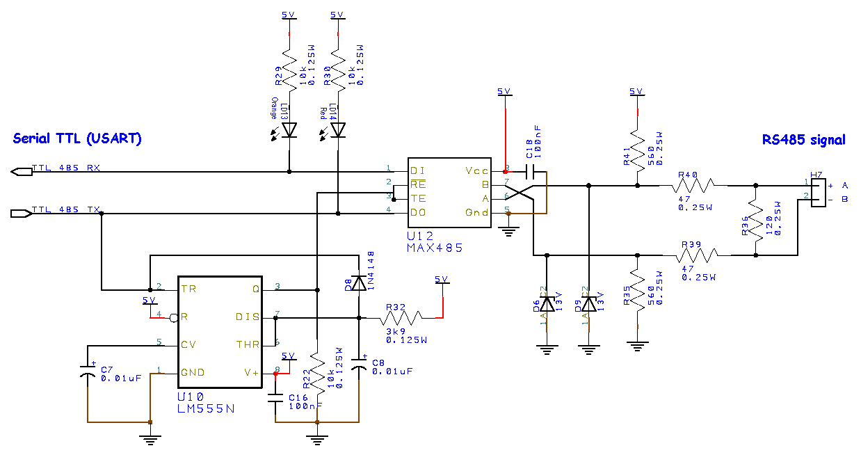

i wanted to implement rs485 communication b/w an avr and a pc.. the reason being distance up to 50 m b/w the two.. i am using the max485 ic, being the first time for such project wanted help and guidence.. i have a rs232-485 converter that i am going to use.
as far as my thw knowledge i have upto now is that aprt from being half duplex, there is no other big difference in coding.
i have the following code for initialization,
well i am using 4800 baud rate because the other functions best suit 1mhz freq.
for a test program that just listens for a byte and echos it back to pc
is this all ok, plz comment on code and give a better one if available....
thanx in advance
if someone can guide me to a tutorial on hyper terminal that would be really a great help...
