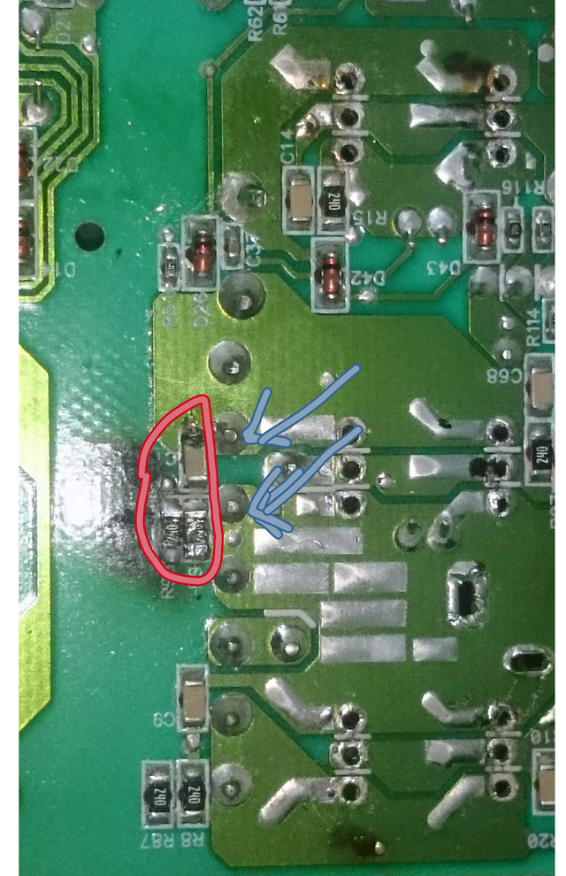

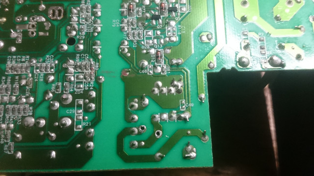

i tested some smd component , found short on the red circle capacitor , i moved it with hot air but the short remain on board and the capacitor where not shorted out of the board so i put it back on>
what else should i examine ?

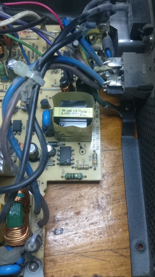

found this diode on high voltage section of the board with number AT02P-200 which is open circuit not shorted nor drop voltage
is that normal? couldn't find datasheet for it
Have no idea which diode you are referring to as the photo is not specific.
However, normally the characteristic of the supply shutting down would be some kind of short.
If testing a diode, lift at least one leg to test otherwise you will get inaccurate results.
How did you test the diode...??(exactly)
Edit;....ah, see now ..D4.
Possibly in the start up circuit given the size of the adjacent small transformer.

Although on board where the diode connecting it's continuity ( shorted)
Took off the board two resistors and capacitor in red circle and tested they are fine.
Although the tow pins pointed at with blue arrows are shorted, guess it's the secondary coil design. not sure

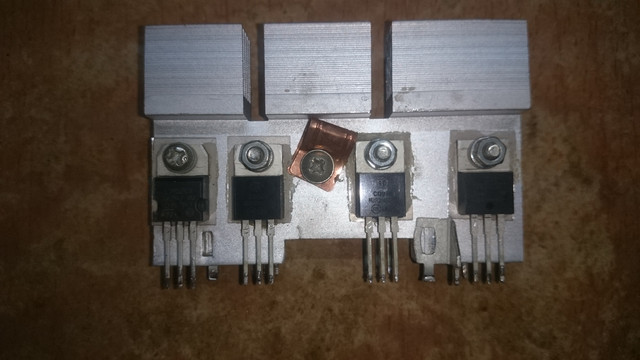

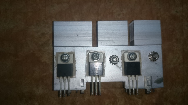

also took off the 6 diodes and mosfet in the next picture and tested they are fine

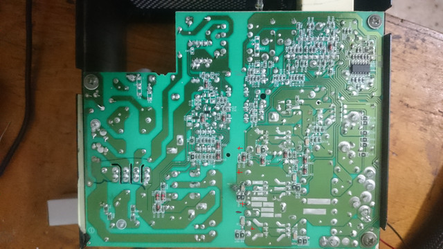

Underside view with arrows and red circles, something looks to have blown up there.
Also above right hand side same photo.
Probably not necessary to lift resistors, especially surface mount as you can easily damage them.
Better to trace back and see if any other circuit section has any influence on the readings.
Cannot see reference point to where you are now as compared to the original diode.

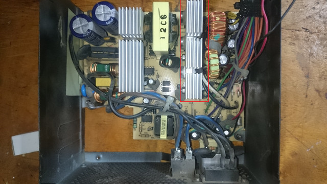

Can see a couple of optos there in the next photo where you have the heatsinks red rectangle, this would be on the other side of the isolation section it appears, from where the diode was removed.

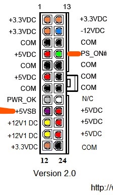

when i connect the PSU to AC source i got 5V on PS_on pin
now when i connect PS_ON pin to ground i got 5V on 5VSB pin only and non of the rest pins.
when i connect the multi-meter to the fan wires and try to start the PSU by shorting green and ground pins i get reads 0.9 V that fade to 0.0 V right away.

i've also tested the low side output voltage of the primary transformer and there's no present voltage, outsource i tested while the green wire is shorted to ground in the connector pin.on the next picture i'm showing how i tested it with multimeter props
is that some sort of IC failure? or is it something else
