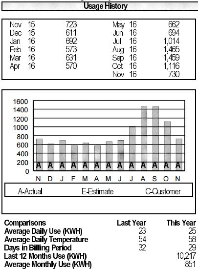

  • How much electricity do I need to generate to cover my monthly bill? Here is a picture of my monthly energy usage from my electric company.

First up, wind generation is iffy at best. If you were to strap one of those 747 size mills to your balcony, then perhaps. 25kwh per day is some serious power generation. Grid connection usually requires quite an amount of supply authority permission and even then, they may or may not allow it. Certainly not with a home- grown system.
Thanks for replying. 25KW per day is my daily usage, so if I could even generate 500w an hour, I would be able to cut my bill in 1/2.
