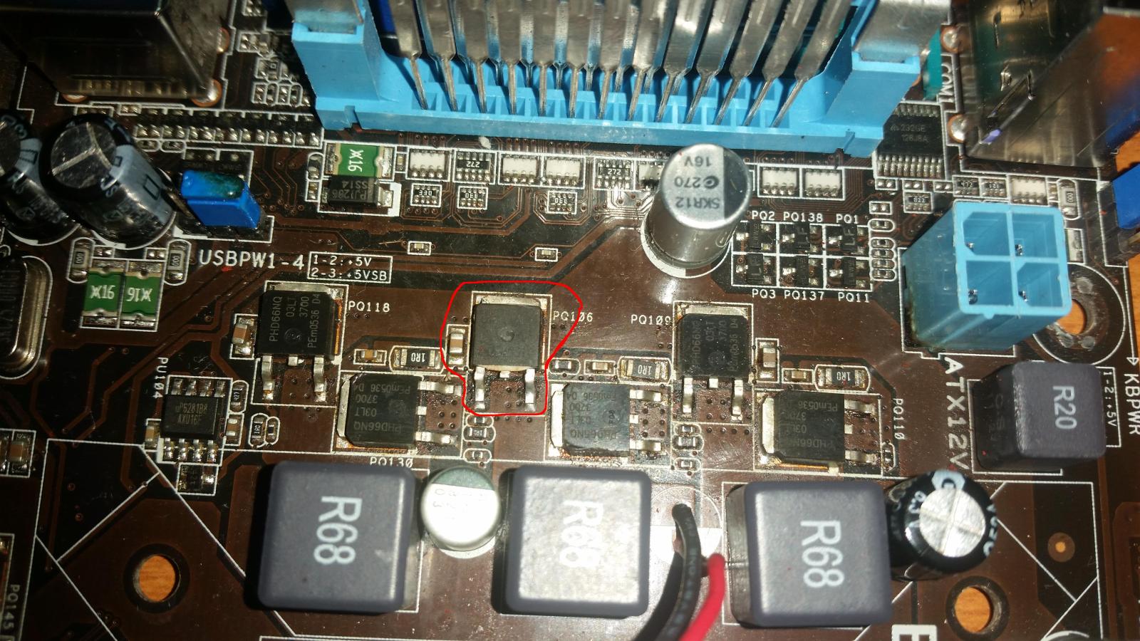

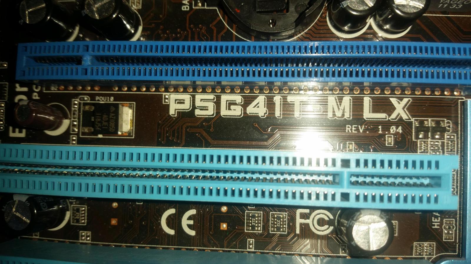

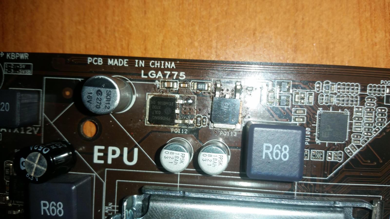

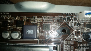

Hello everyone! I've came here to seek for wisdom of more experienced people. The problem I have with my motherboard ASUS 5pg41-m lx is that there is a short somewhere and for the love of God i can't find it. There is one specific mosfet that burst every time when I replace it. There are 8 of them around the CPU and it's always the same one, the other ones always survive. I thought that my CPU was shorted at first, but after changing 3 CPU-s, the problem is still the same. I did found one shorted capacitor but that was it. Has anyone maybe came across the problem like this or had similiar experience. I would like to hear your opinion on this matter. Here are some pictures. There is flux on the board from resoldering mosfets on the motherboard. The circled mosfet is the problematic one. Also the two wires coming form the motherboard are connected to a capacitor, it couldn't fit between the coils so I just put it little above(that was the shorted one).
