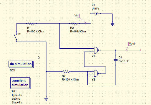

I'm not sure what kind of circuit should do that, though a 555 might be in there. I found one circuit, they called it a one touch pulse (attached), but they were touching the wires with their finger tip, so that resistance could be part of it. But when I tried plugging it into Qucs and running a simulation, I either have it wrong, or it doesn't work. The NAND gates were listed as a CMOS 4011, but Qucs doesn't differentiate other than it being a NAND gate.
I'm sure I can figure out some logic with the extra NAND gates on that chip or something else (inverter?) to get the extra pulse when it's released. But the other issue is ensuring the second pulse is at least one second after the first, and a new first pulse (press) is at least one second after the previous second (release).
