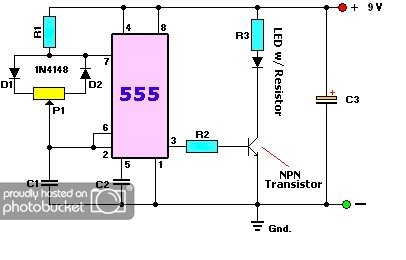

My current project involves trying to make a battery-powered LED dimmer circuit. I''ll be using a 9v battery to power a single LED. In order to make the dimming linear (preferable) it appears I'll have to make a circuit like the one on the bottom of this page:

Here is a basic outline of the schematic I think would work. What I need help determining are the values of the capacitors, resistors, transistor, diodes, and potentiometer. I'd like the circuit to be variable about 5-95%. I'll be including a switch in this circuit as well.

Hi candlepin,
I kinda realised my last post missed the point a bit.
If you want to use the 555 timer, the values stated on that web page you referenced can be used for 9V as well, i.e:
R1=1k
R2=1k
P1=50k
C1=0.1uF
C2=0.01uF
**NOTE: Decreasing C1 and C2 will increase the switching frequency
C3=can be any large capacitance, you can pick 470uF if you like. It's just there to take a bit of the ripple current away from the source.
R3=is to limit the current through the LED, it really depends on the LED that you choose but for a 3V LED you probably want somewhere around 300ohms.
I ran a few simulations through Saber for 12V and 9V and running the circuit at 9V doesn't appear to change the frequency or duty cycle much (the change is less than 1%).
Also, try using a high gain NPN transistor such as a Darlington. They work off very little base current and have extremely high gains. A good one to use is the BD681, they can handle about a 1 amp (more than enough for an LED) and have a very high gain, and best of all they are really cheap!
