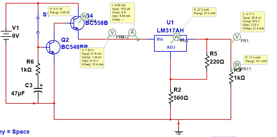

Hi! I have this simple circuit that activates a load, whenever the switch is pressed (shorted). When the switch is released from being pressed, the load will power down slowly. I have already put this up on a breadboard. When the load is an LED, it works! But the actual load that I will use is a 2W MP3 Decoder. The load only receives 17.4 mW (based on my schematic diagram below) but before reaching the LM317, the power is 4.11 W. How can I make the load receive at least 2W. Please help! Thank you!
