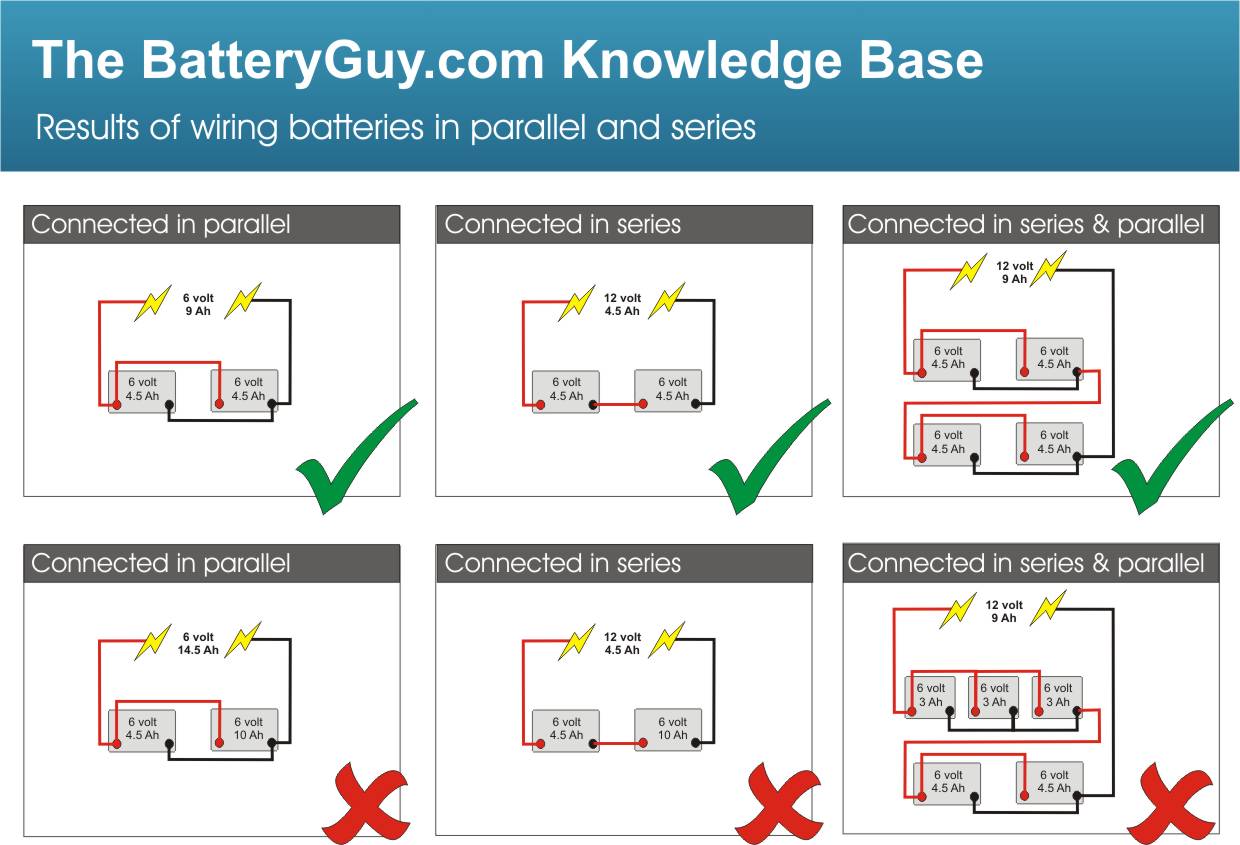

OK, so I'm going to try to visually wrap my head around the step-by-step process in order to do it (to make sure I have at least 5 volts going into my Arduino) by connecting 8 AA batteries in parallel to see if I can keep it going for the time it said it can.
A: Make two 4 AAs in regular series to get 6 volts.
B: Connect the two sets in parallel (negative to negative, positive to positive).
C: Connect negative from one pack and positive from the other into the Arduino (will need to get another barrel pin connector for that).
Am I on the right track?
You are assembling 8 AA cells in series/parallel making one fairly long lasting 3.6V to 6V battery. The total battery has only one negative and only one positive for one barrel connector.
I think I got it to work. I used my two 4 AA battery holders and twisted the negatives and positives of each packs to one another. After that I stuck wires from the negatives of one pack and the positives of the other (like in the illustration I linked) and I tested it with a multimeter. I got a 6.5 voltage from the whole 8 pack. I think I did it. Best part, no soldering or permanent modification of the packs, so I can reuse them for other devices as needed.
