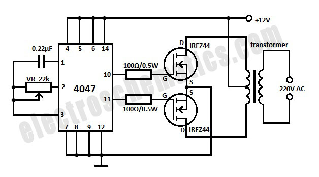

I started out with the intention to build a standard no frills 240ac from 12v ... i have an old toroidal transformer (ac 240 down to 12v/10v - 0 - /12v/10v) 150w from a cheap amplifier
simple enough... so i thought maybe i could go one step further and get a sinewave...

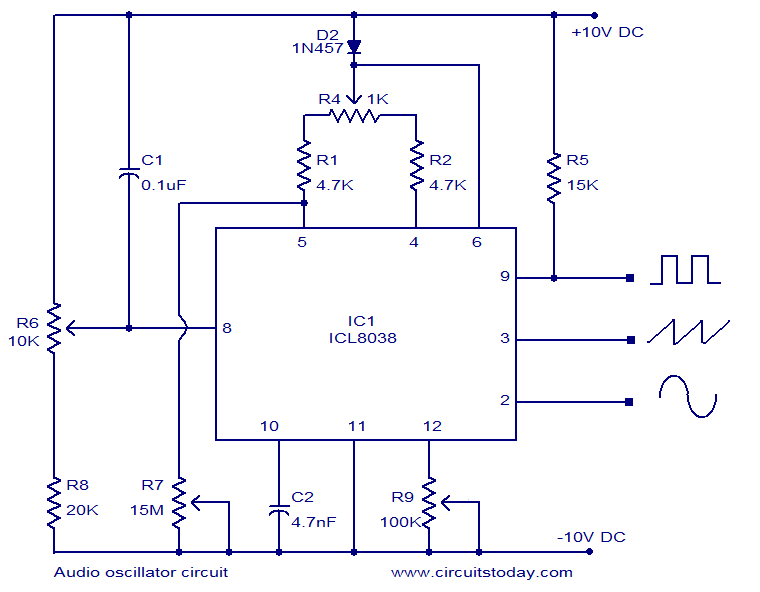

Now the bit i'm unsure of... the 8038 produces 0v to ?v there wont be say 0v to -10v only 0 to 10v i'll only be getting half the power i should on output...
is it worth the effort to shift the voltage down or just use as is?
