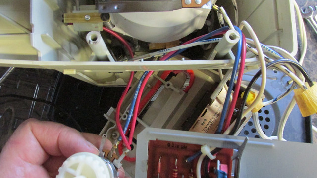

Wiring from speed dial to board:

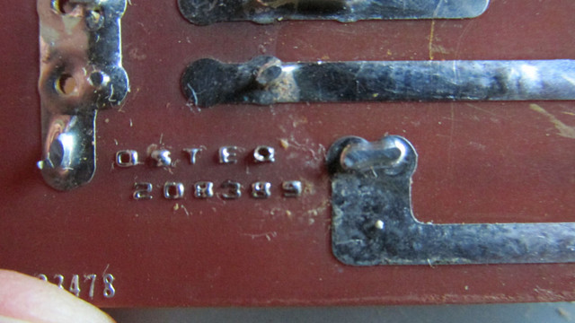

Board ID number (Oster 208389)

Yes, not quite sure what the setup is there.
