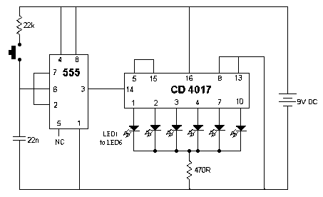

I believe that this circuit is from www.talkingelectronics.com
There are 100s of circuits online to choose from.
The output on pin 3 is definitely different to yours. But the dice is just a random number.
The supply is a pp3 9v battery.
Martin

Yes, sorry. That circuit is random with each switch press...
But like I said, there are loads of circuits online.

The circuit in post #2 can be the starting point for a dice display. That circuit runs at a constant speed until the switch is released, then stops dead. Another variation is a "Wheel of Fortune" circuit that emulates a rotary game wheel in that it starts out fast, then slows down to a halt. Some prefer this kind of visual effect.
Either way, once you have something that spits out 6 states you need to adapt that to 6 light patterns. While this can be done with gates, it is easier to mess with if you use small signal diodes (1N914, 1N4148, etc.). Assign a reference number to each LED, make a table listing which LEDs are to be lit for each of the 6 counter states, and connect each LED to its assigned counter outputs with diodes. For example, the upper right LED would be lit for numbers 4, 5, and 6, so it would have one diode to each of those counter outputs. This is called a diode-OR circuit.

It's not a random pattern, just a pseudo-random system because the clock is so fast relative to the time it takes for a human to press and release a button. There are 6 4017 outputs and 7 LEDs. Thee only real problem with this approach is the low output current of the 4017. At 20 mA per LED, a 6 needs 120 mA.

With a 4017, I normally put a transistor at every output used to power more than the original.
