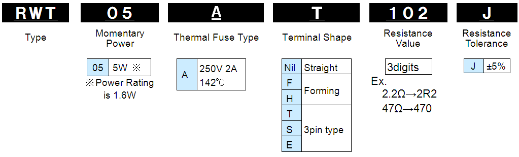

According to this code reading it looks like is 5W
Here is the whole description:
http://www.akaneohm.com/products-data-eng/rwt05a/
Spot on with the tech spec. The two-pin version should be fine unless you're in the habit of bouncing the TV around a lot.... but ideally a like-for-like substitution is always the best option.
