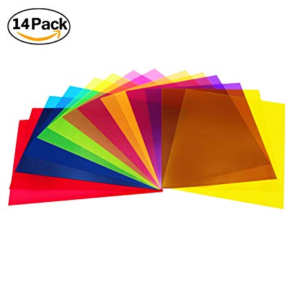

Look for clear-colored plastic 'dividers' for folders at the office supply place.
