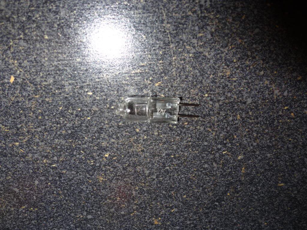

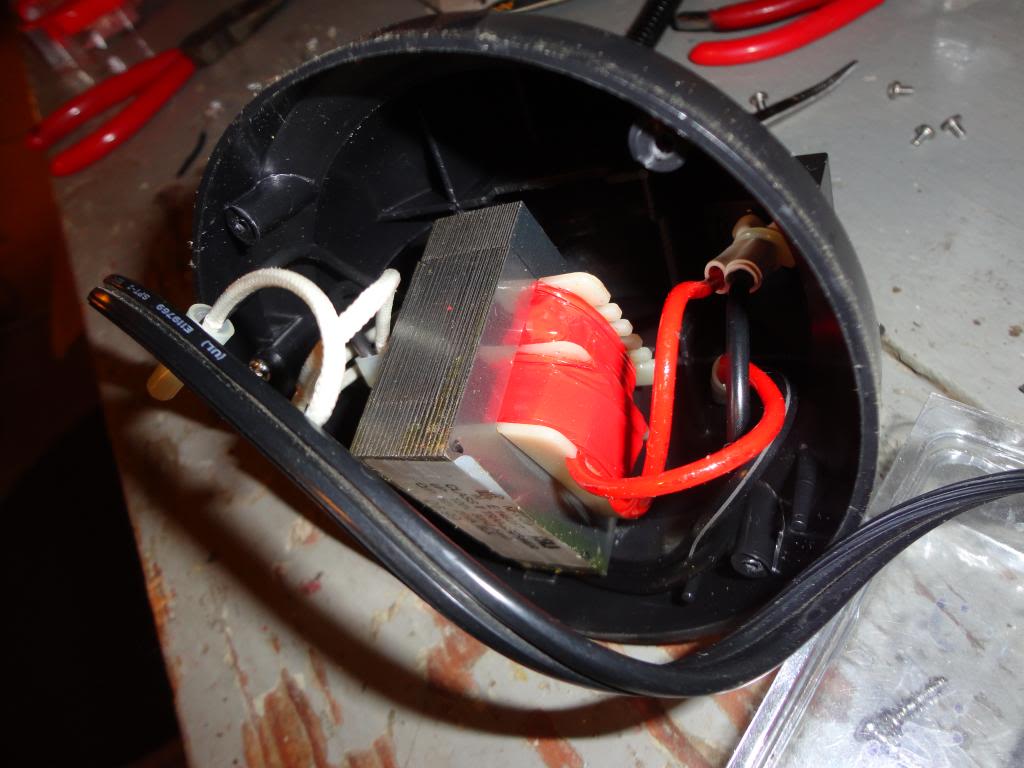

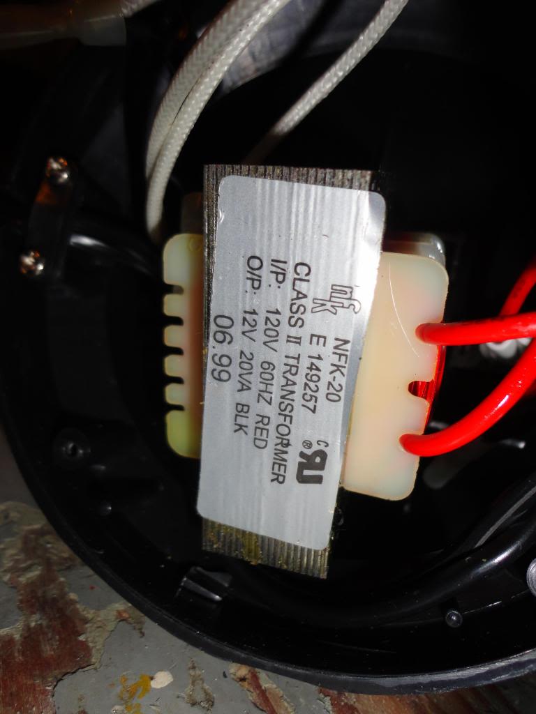

The lamp has a transformer coil inside it. I took 2 pictures of inside the lamp still unmodified (2nd and 3rd pictures below). The voltage on the load side is about 14 volts AC (measured with a DMM). Its rated "12V." The bulb looks like a car headlight (1st picture below).

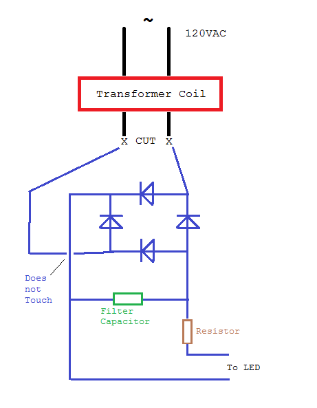

In order to run an LED, I need to convert the AC signal to DC. So I figured I'd make a bridge rectifier out of 4 diodes and use a filter capacitor to smooth out the bumpy DC.
I made a cheap diagram in MS Paint to denote the modification I plan to do (the 4th picture below). I plan to cut the output lines coming out of the transformer coil (that originally go to the bulb) and solder the home-made module there. The home-made module I'm adding is drawn in blue. It entails the bridge rectifier, the filter capacitor, and the resistor.
My question: I need to know what filter capacitor to use. I don't know much about capacitors. I'm not even sure if I'm supposed to put it in parallel like the diagram shows. Can you give me advice on which capacitor to use and whether I should put it in series or parallel.

- The bulb is a 12V incand/filament bulb. The lamp hood says, "Use 12V/20W JC Type T or Smaller <bulb picture> G4."
- The LED: Forward Voltage is 3.2V, and forward current is 60mA. I will use a 1-Watt 180-Ohm resistor.
- Bridge Rectifier: I will use 4 1N4000 series diodes. These are rated at 1A continuously.
- The measured output voltage on the load side is about 13.8VAC. I measured this by sticking the DMM probes into the socket holes where the bulb plugs into.

Stock Bulb:
Transformer Coil
Diagram
