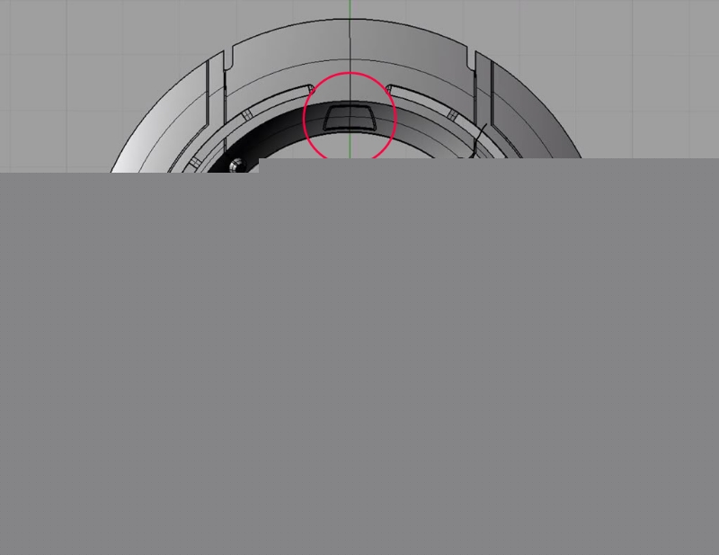

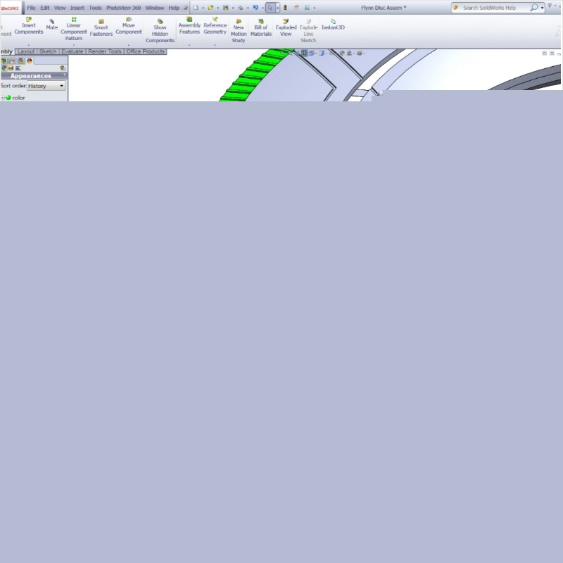

As far as the LED being used on a 90 degree angle; I have only ever seen 3mm LEDs in a little plastic holder that hold them at 90 degrees. Others may have a solution for you, but my first thought is using a 45 degree angle on the inside edge of the outer-ring light-pipe to hopefully reflect the light outward. (I have very little experience with light-pipes though.)
