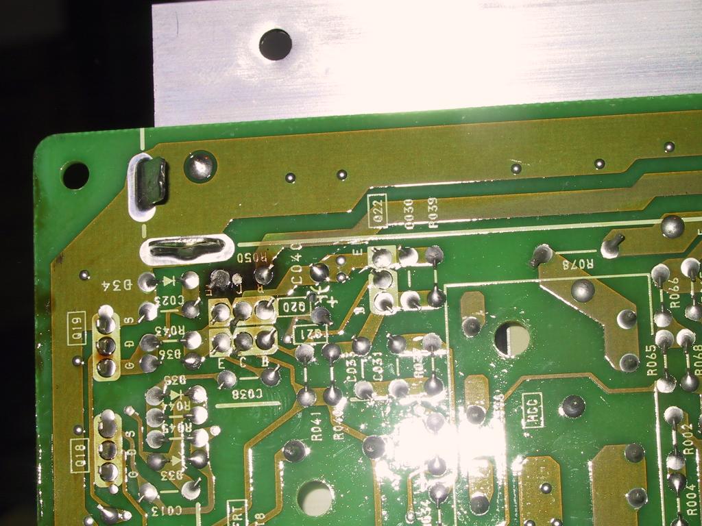

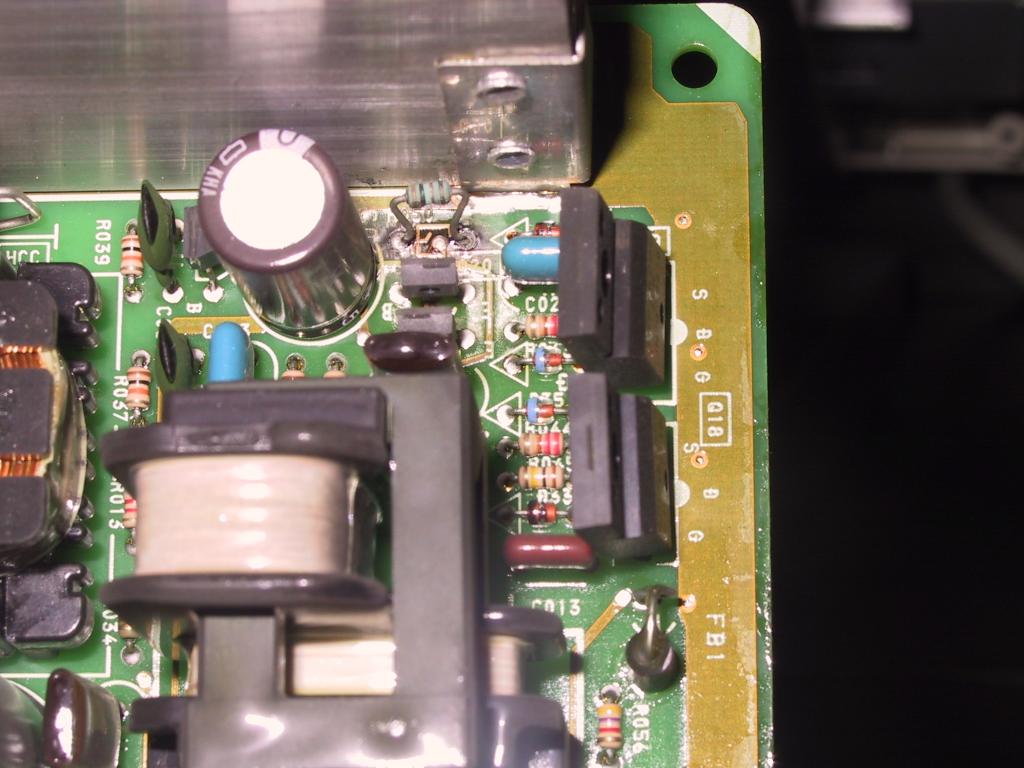

In my continuing saga to fix this sun/sony gdm-20d10 I pulled out the D
board to look for capacitors to replace. I noticed a burnt up resistor,
which completely open:
http://www.aberrant.org/~aarons/img_1869_small.jpg
http://www.aberrant.org/~aarons/img_1867_small.jpg
(remove the small for the fullsize image)
The colors are hard to tell in the image, but they appear to be orange
black brown gold, for a 300 ohm. Before I go and replace this, I'd like
to know what the value is really supposed to be, since what looks like
orange might be brown, and what looks like brown, might be purple. If
anyone knows where I can lookup R050 for this monitor, I'd appreciate it.
My other fairly obvious concern is "why did this resistor fry?" There's a
cap (C040, 160V 4.7uF) which is on one of the nodes, so I'll probably
replace that just for good measure. Everything else on the board looks
perfectly fine, so testing this seems difficult.
Thanks.
-Aaron
