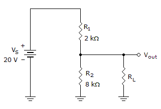

I get 1.96mA through R2. I obtained this by first calculating the output voltage. It would then seem that the bleeder current is the wasted current through R2
