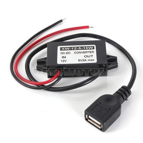

The 12v to 5v converter i'm looking at is like this: not sure if it will have a fuse inside that housing. So considering maybe to add an inline blade fuse maybe on the red wire. Is that ok? and what amp fuse would be recommended?

I don't see any reason why they would not sell them..
But if not, a glass inline would be perfect too.
