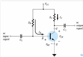

For the following Fixed bias emitter stablized circuit
the voltage swing from Vcc to Isat RE; that is the ac signal is carried on VC dc voltage and swing up from Vc to Vcc and down from Vc to Isat RE.
My question about the second fixed bias circuit that follows
is the voltage swing from VCC up to zero down?
Is it from VCC up to Isat re down, where re is 0.026/IE?
please help.
Another question: For the second circuit If Rc= 1.5K and RB=540k
what the maximum peak-to-peak i/p signal voltage that can be amplified without distortion.
thank you alot.

Since the bias is not done with a voltage divider, in the second case (and in a slightly lesser extent the first) the gain of the transistor determines the resulting Vc.
Since we don't know the gain of the transistor, we can't say much.

thank you steve for reply
I'm not understand you!
for the second circuit Vcc= 3 volts, beta = 230, 2N3904 transistor, VBE=0.67V and IC =1mA.
its not h/w i study it alone
thanx
