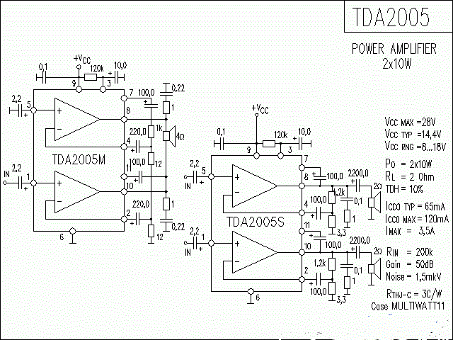

As shown above title, the subwoofer amplifier circuit I made with tda2005 has a lot of current noise, I post the circuit directly. I referred to this pdf of TDA2005.
