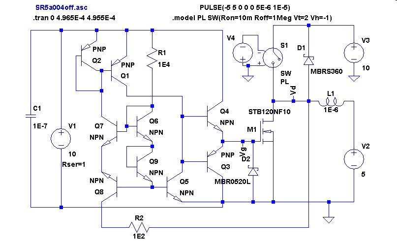

Some of you may be familiar with issues around self-synchronizing
normally-off
mosfet rectifier control. This is basically an attempt to get mosfets
to behave
as 'ideal' rectifiers, using the simplest control method - a linear
negative Vds
regulation in the third quadrant.
Apart from the issue of accurately modeling the integrated version of
a controller, the behavior of the mosfet body diode is creating
modeling anomalies.
Drain currents flowing as the drain voltage rises at turn-off do not
seem to be related to current levels experienced by the mosfet
parasitic diode - rather they scale to current flowing through the
enhanced mosfet channel at turn-off - a structure that is supposed to
be storage-charge immune.
web page with links to swcadIV files and pdf format are available at:
http://www.magma.ca/~legg/20_Years/1994/1994h.html
images of simulation traces and representative schematic at:
http://www.magma.ca/~legg/SR5/SR5a004on-Lstep.jpg
http://www.magma.ca/~legg/SR5/SR5a004off-Lstep.jpg
http://www.magma.ca/~legg/SR5/SR5a004off-sch.jpg
Any ideas, please comment.
