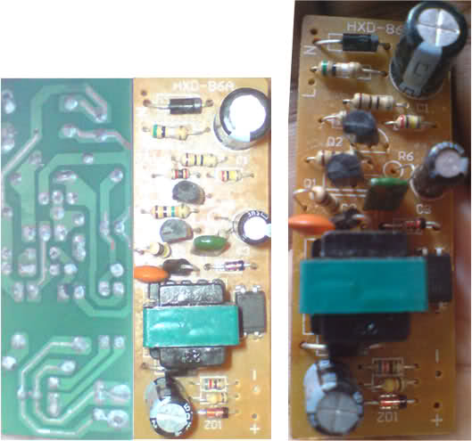

If it died due to a short on the output, I have bad news...
There was no OCP (over current protection) in the circuit, I would wager that your controller IC, at a minumum, has died. Your switching FET/BJT, maybe even the transformer, if it's not somewhat robust, would be suspect.
The zener across the output is there to keep the the open voltage (the voltage when no load is connected) clamped to a reasonable level. An SMPS (in a constant current/power config.) no-load output voltage is much higher than when loaded, which could reflect back and destroy things on the primary side. A short would not be protected by this zener, obviously, since there would be very little voltage across a short, but MUCH current... enough to smoke things pretty quick. Most decent SMPS will incorporate OCP for just this reason, and it's usually integrated into the controller IC. Wonder what they're using for the controller...
What is written on top of the controller IC? It's probably the only IC on the board, aside from the optocoupler.
No +/- markings.Are you sure the "photo-coupler" doesn't have + ~ ~ - markings on it?
The diode has a ring. No symbol on the board for this part.The "diode" standing up next to the orange cap. and transformer ... is there a ring on one side or is it solid black?
Is the small resistor right above and closest to the upper-most transistor burnt in the middle?
With at least one lead of R3 unsoldered, what ohms do you read?
... what colors can you make out?
Now I'm intrigued. Can you do me a favor and measure continuity on the transformer? With the power off, mind you. Just trying to figure out which pins are making what winding.
R3 reads 8.1K. and i'm guessing the colour might have been green, 2.5K?
How is the primary side wound? 1-2 and 3-4 or 1-4 and 2-3, etc.?
Also, a part number or marking for those transistors would help.
Yes ... Red, Green, Red = 2.5K ... So we know it's between 2.0K and 2.9K, right? Quite a ways from 8.1K. If those are 1/4 watt ... I would up-it to a 1/2 watter.
I thought you had already done it, but if not (like he said) check all your diodes and transistors for shorts and opens.
You marked the polarity on the DC out wires so you know where they go when it comes time to solder them back on, yes?
A little confused... this is how I'd expect the xfmr to read, red lines meaning continuity:
Is that what you're reading?
Hmm, Q2 is totally shorted out & Q1 is totally open.
What do you guys say?
