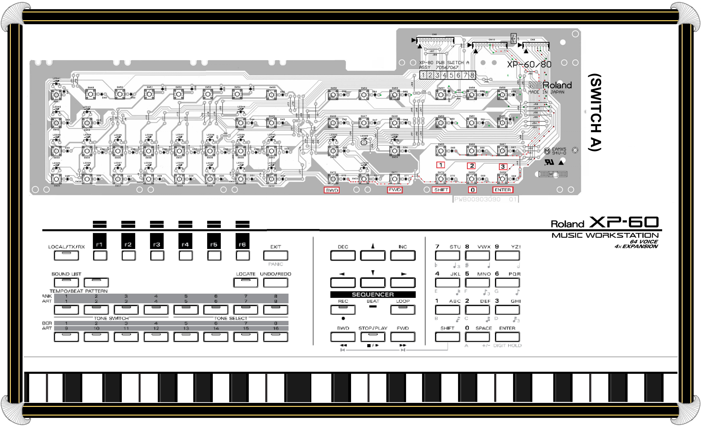

I have no experience with those but imagine the general procedure is going to be opening it up, seeing if there is any fluid that was spilled in, check whether the switch that each faulty key activates is working (continuity or resistance multimeter measurement), or if this group shares some common component upstream, or a circuit board trace is bad.

Here is your problem area, now being all marked up for more in depth analysis .
Get the unit having this portion accessible for taking readings . . . . and call back.
TECHNO - REF . . . . .
73's de Edd . . . . .

I assume that you might also need the full possibilities of solving your problem now.
I took particular attention to do a mark up of just the push buttons :
BWD FWD SHIFT 0 ENTER 1 2 3
that seem to be inoperative on your unit.
If you then examine the combination of interconnected foil paths and jumper wires associated with those buttons, you will see that they start with BWD as its SW72.
BWD /SW72
, if pressed down, connects a D72 steering diode into the marked multi RED dotted path that ALSO has all your other INOPERATIVE keys tied into that same line that eventually has to pass through JUMPER WIRE J48 (? bad solder connection ?) and JUMPER WIRE J62 (? bad solder connection ?), until a final ending of all of those series of interconnects at the top of page connector CN10 and its pin #7.
A logical first test now would be to have an AC UNPOWERED unit and do a LOW OHMS continuity / expecting almost ZERO ohms , from the cathode of D72 diode to the final end of all interconnects at pin #7 of CN10.
( You possibly might also later find out that you need to track down the wire within the wiring harness that contains that #7 wire connection, down to ITS origin / source also . . . . . somewhere else in the unit. )
If that series of interconnections are all good from SW72-------CN10 #7, a shorted or leaky steering diode of D-72, D71, D70, D69, D68, D67, D-66 or D65 could be causing all of your mentioned dead keys.
Now look at the ENTER D68 associated diode and you will see that the ENTER SW68 has a RED / BLACK dot path routed up and ending at CN8 #5.
You would have only that key inoperative on a loss of series interconnections, or your tracking out out the other 7 switches and testing their connections . . . . . I do not expect a problem in those series of connections.
Finally, since I am expecting all of the rest of your keys to be operating properly, I did a lesser mark up with many fewer GREEN dots on the same type of a set of 8 keys, that end at CN10 #6.
Also, the same treatment with GREEN / BLACK dots to its CN8 #6. You could do a comparative resistance test between like parts of the GREEN and RED dot circuitry to see what is different.
SUSPICIONS . . . . .
After the initial series of interconnections of that set of bad keys I am expecting a bad / shorted / leaky diode that is disabling the whole mentioned cluster..
As far as all of the TACT switches , I have only found open or no-makee-connection faults with them , I have yet to find my first SHORTED TACT switch.
