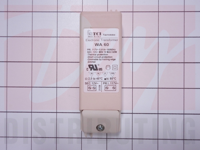

Transformer on range hood died, so that the two 12 V halogens quit working. Fan unaffected, still works. My question is whether I can replace this original:
480
with this much less expensive transformer, also from a range hood, different brand:

If I read it correctly (it is a bit fuzzy) I see the original is 12V 60W which is 5A and the replacement you want to use is 4A. So, no you need a slightly higher power one.

The original has thermal and short circuit protection. Do you want to lose these facilities?
Try repair if you can get inside.
Thanks, guys. I guess this isn't a viable replacement. The original (no continuity) shows signs of heat on the backside of what I understand is the transformer. I think I'm going to go ahead and order the pricey replacement. But here's pics of the original's internals:

Okay, there's something I don't understand here. The "transformer", which is repeatedly being referred to as a transformer, is obviously an assembly of components built around the actual transformer. This appears to be one of those jargony things where an entire assembly of components is called by the central element.
I've worked decades in an industry that uses transformers that are actually just transformers--even though most of them have a fuse inside the housing, but those that don't are still transformers. So I'm curious here: I know that an incandescent light source can work on whatever voltage it's designed for, and a 12VAC step-down transformer in the USA will deliver a nominal 12VAC (actually closer to 14VAC OCV in most instances), but it's the voltage that the bulb is designed for.
What is all the extra circuitry for?
Basic switchmode supply. Designed to keep the size of the transformer small by changing the frequency usually. Input rectified then changed to different frequency then stepped down.
