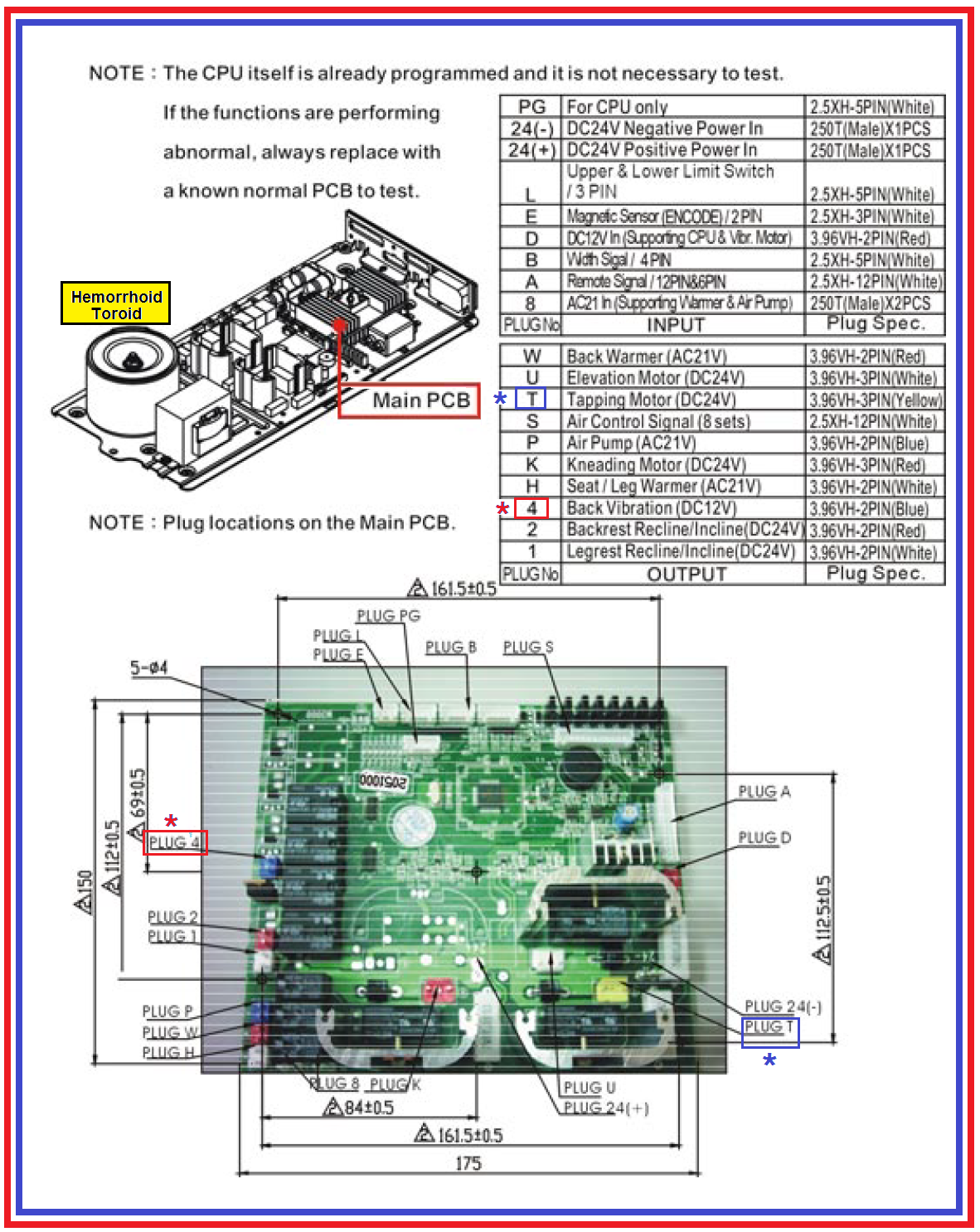

My php2026 has the vibration feature running all the time when its plugged in. It doesn’t matter if the unit is turned on or off with the remote, the vibration continues as long as the chair is plugged in. All the other features seem to work as designed. Is there a way to remove power from the vibrator motor(s)?
Sir sid . . . . .
Consult the info below and you will see that the top legend references are telling you:
That the RED asterisk mark up, confirms that if the BLUE PLUG 4 is unplugged, that will disable the vibrate electro-mechanics.

Thanks VIZ! Sounds like exactly what i wanted. Will try to find the pcb in the next couple of days.
Dr sid, that's a new one. Usually it's something that doesn't work. Yours over-works. ;)
Anyway, the solution 73's de Edd provided should work. Alternatively, a simple/quick solution would be to lift the seat cushion (mine's simply held on by Velcro) and disconnect the wire attached to it. Took me one minute to test mine.

Thanks! That was easier, but didnt fix the problem because the vibration is in the back, not the seat.
Sorry about that. You didn't mention back vs. seat in your original inquiry. Given the diagram 73's de Edd provided, his solution should work.
I thought they might be connected together, but wasn’t really sure which was vibrating. Maybe both! I’ll get to the pcb and disconnect plug 4 tomorrow. Thanks again for all your help!

Thanks to everyone for the help troubleshooting my massage chair. I have successfully disassembled the chair to gain access to the pcb. I then unplugged the blue plug 4 and reassembled my chair. wallah… the chair works fine sans the vibration feature that i didn’t like anyway! You guys are the best! Many kudos to y’all!
