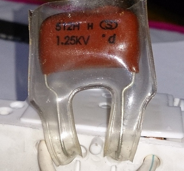

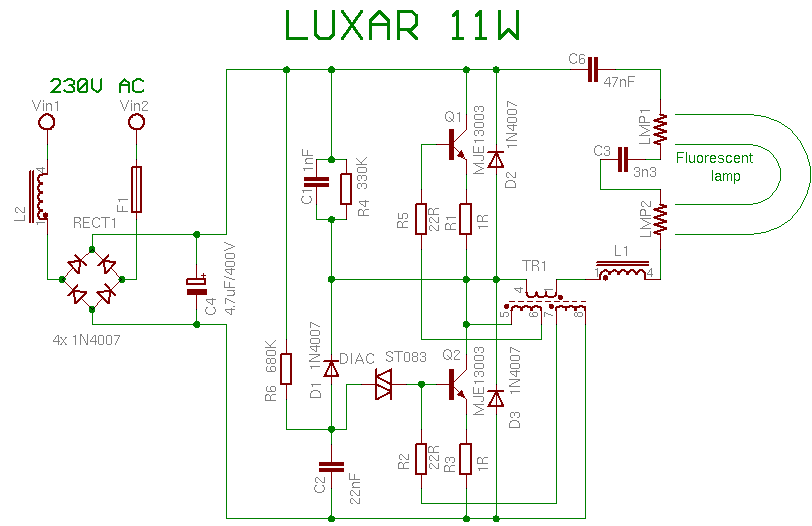

I have a National desktop fluorescent lamp that failed to work. Every time I press the power button, it blink once and doesn't light up. When I then press the button again (intended to put it to off state), it blink once again after 8 seconds. I trace the PCB and found that it is almost the same as this one.
except that the values of the components are different. The C3 is 1.25kV 5.1nF while the C6 is 400V 470nF. I suspect that it is the C3 that failed. Photo here
I don't have exact replacement, but I have two 630V 10nF
and thinking of connecting them in series to replace C3. I think the calculation is correct, but I don't know if the type of capacitor and the current loading match as replacement or not. The 10nF is much smaller in size. Can somebody please help me on this.
