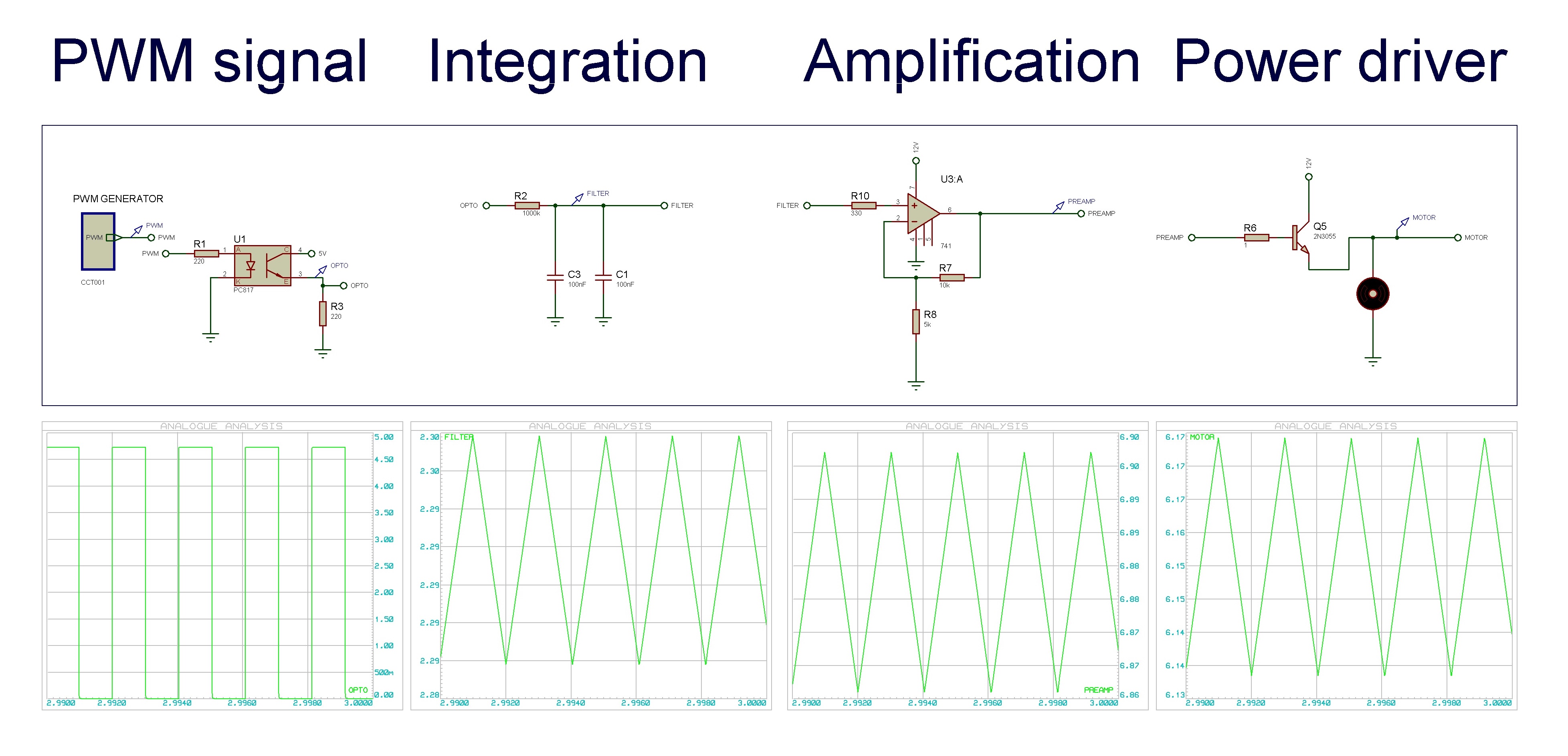

Hello, I am building a PWM controlled power stage for a motor.
I have created a circuit in proteus and it works, kinda cool, but, I have the feeling it has to be inproved and some questions about Integrating the signal and how the transistor 2n3055 works. I would like somebody elses opinions and corrections.
The target is to regulate the voltage of a load via PWM duty and 2n3305 transistor.

Explanation
1. PWM signal.
No problems with this. An arduino creates a signal via analogWrite, ino file included in sources.
2. Integration.
In order to convert incoming signal from PWM into a integrated signal, I built up this Rc filter, I can see is not the best one because R2 is too high and its take to long to become stable.
I would like to inprove this in order to flaten the signal. Is the way Im using correct?
3. Amplification.
A Non-Inverting Operational Amplifier will amplify the voltage of the integrated signal X2 volts aprox, in order to create 0-12 volts from a 0-5 volts range.
Should I use a BC547 or TIP31 or any BJT transistor? or OPAMP is better, I think the second one is more appropiate but I may be wrong.
4. Power driver

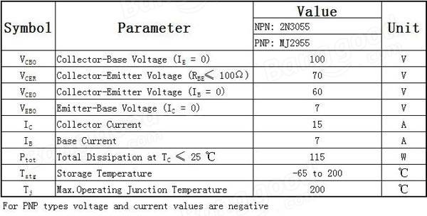

I have to use a 2n3055 transistor because i have it, and because due to hardware settings it has to be npn.
He is able to work in the power range I need as we can see in the table above.
I reached the resistor values by empirically trying with proteus, thats why i have serious doubts about if its right.
I dont know how make it safe and be sure. It seems it works, but I dont know if this is the best way.
2n3055 table
