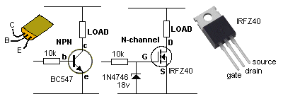

It may be simpler to provide protection for the gate. This is achieved by placing another (low value) resistor in series with the connection to the gate and a zener diode across the gate/source resistor. I would advise choosing a mosfet with a 20V (or higher) Vgs(max), using a 15V zener, and a 220 ohm series resistor for your 12V signal. (this assumes you're not powering a heavy load or switching it a lot.)

edit: here is an image that shows gate protection. Note that there is no gate/source resistor shown. If present, it goes across the zener.
(It's the picture in the middle :))
