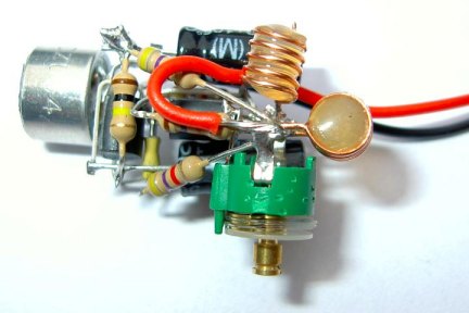

I have a FM transmitter circuit with exposed air wound coils - I have seen some ppl put a substance inside and over the coil to protect it - I've tried in vain to find out what this is - is it silicone sealer?

The coil determines the frequency - so I don't want the coil to bend and change the frequency. Handling the PCB sometimes will bend the coil.
Like this:
Note the coils - is this silicone sealer?
no idea, but adding this stuff will probably affect the operation of the device -- it may just require retuning, but you never know.
Then again, considering how this has been built, I guess there's quite some leeway...
This is a sample of a bird's nest design I found on the internet try and show what I'm looking for - I built a kit on a PCB.
Not in your example picture, in the radios I've taken apart throughout the years. Your photo appears to be hot glue or an epoxy.

Cool - that is one idea. I suppose since the epoxy does not conduct it will be ok to fill the coil with that.

I tracked down a very old post on another forum that confirms that hot glue works well - if anyone else has this same problem
I use hot glue regularly for dead bugging but when it goes on conductive areas we prefer DOW 3145 RTV because the circuit doesn't have to get very warm before the hot glue starts to run(among other reasons).
